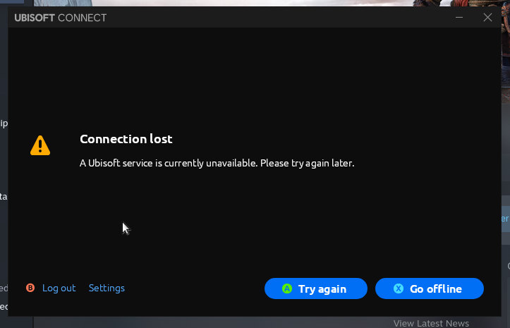

I went to launch Assassians Creed Vahalla tonight, but I got this instead:
I spent an hour trying to sort it out. Restarting Steam and restarting the machine made no difference and it's the same thing with all Ubisoft games I tried. I tried it on two other machines and it's the same there too. Also can't use offline mode, it just says the game wasn't installed correctly and won't allow me to launch it. I did an integrity check and no problems found. Guess I won't be playing that game tonight then, or any Ubisoft DRM game. Déjà vu.

Unfortunately none of that worked. After removing the launcher folder it just complains about it being missing, and it wouldn't reinstall it. Eventually after multiple attempts and multiple restarts of Steam it did, and then it was right back to the same connection error. I tried your Proton and some other Valve versions but the results were the same with each one. I finally just deleted the whole prefix but after it recreated the prefix it was back to the connection error.

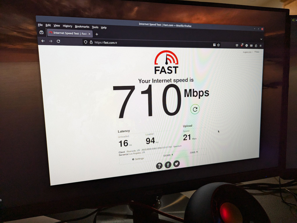

Here's my current speeds. I got a recent speed boost from Spectrum about 3 weeks ago, they did this across the board (now that I'm going to be leaving). I was previously around 500 Mpbs before they upped the speeds.
Re: Ubilauncher Fubar
The important thing is, do you think that has suffered with the smaller MTU?

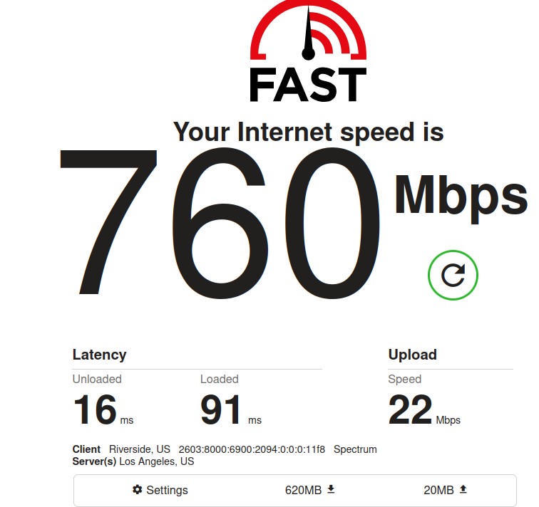

Not that I can tell, everything seems normal and I compared it to an earlier test:
I do have some buffer bloat under load that was there before, I get a 'B' score for that on the waveform speed test.
