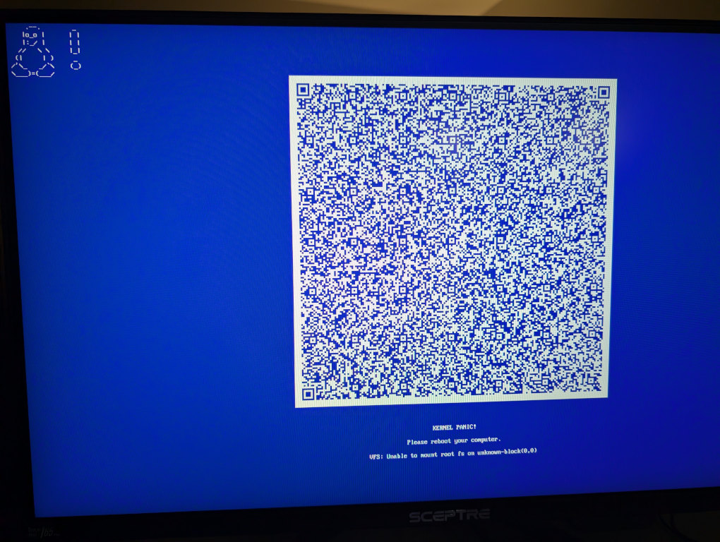

I played around with the issue with the zen kernel again, I removed the kernel along with the initramfs image, then reinstalled it (different kernel version), but same thing happened.
At first after reinstalling it I forgot to run grub-mkconfig -o /boot/grub/grub.cfg before rebooting, with the result that I saw my first Linux BSOD lol!
Re: Arch Linux 2024
That looks ridiculous. I have that shit turned off in my kernels.
It gives the intelligible info though, "unable to mount rootfs", at least.
