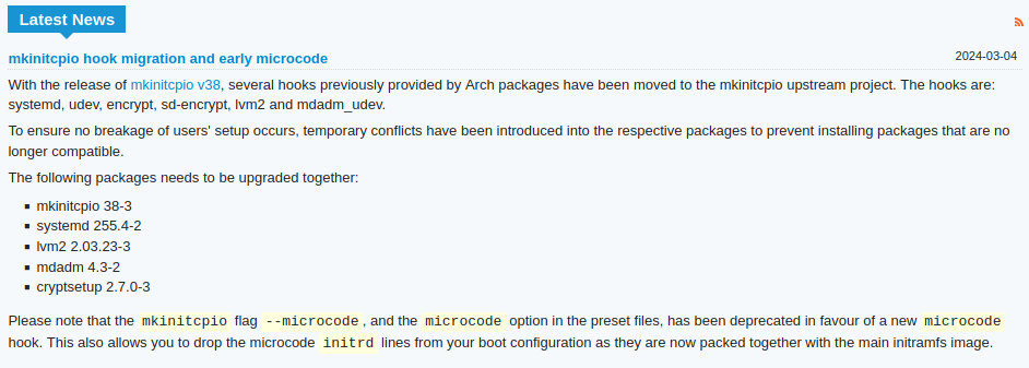

Re: Arch Linux 2024
This is in the Arch news today:
Posts: 2250
Re: Arch Linux 2024
So... deliberate sabotage, then. That's why I had to jump through all those hoops to resolve those impossible conflicts.

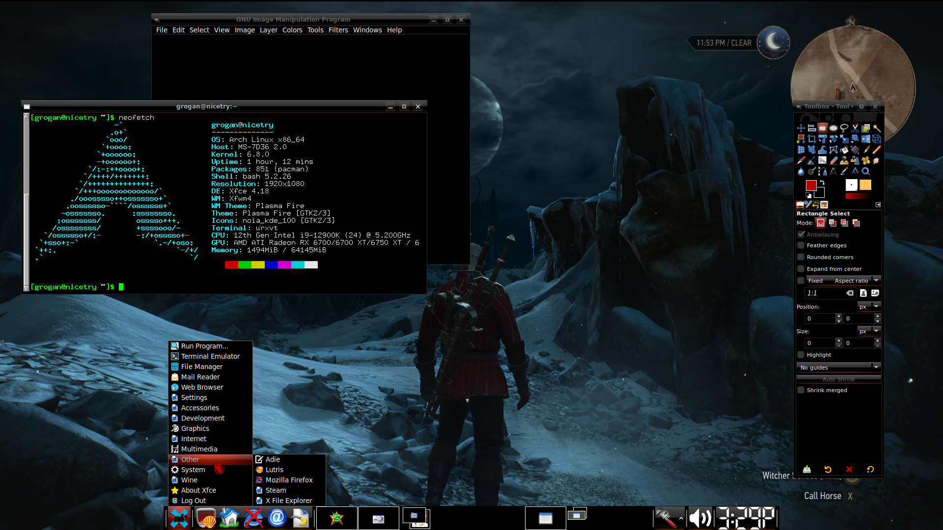

I'm using XFCE for non gaming, and my trusty IceWM for gaming. This way I can use gaming-adverse settings like focus follows mouse, and workspace switching at screen edges etc. for XFCE. It's better for workflow.
I haven't finished populating my panel, and I have some broken icons that no longer jibe with the fallback icon names in Adwaita (My Noia icon theme is both old and incomplete for modern DE's, but the main ones all work and it's my favourite icon set). It didn't help that I blasted over .desktop files and stuff from the old home directory either (which is where a lot of those applications are even coming from in the menu... many aren't even here yet lol)
I miss my old XFCE 4.12.0 but that's not going to work correctly on Arch (or possibly even compile) like it does on my LFS system. I keep the minimum versions of the GTK libraries and related dependencies to function, because I like a lot of old programs. Also that old version isn't aware of newer desktop technologies and the way X is handled under systemd. I tried it once a while back and while my compiled binaries ran, it did not work correctly.
For example, adding a launcher where the icon is only going to be a flyout launcher and not do anything itself (like my Utilities icon with the wrench). It doesn't let you do that anymore. So what I do is make the target command /bin/true so it silently succeeds at doing nothing if clicked :lol:
Both bottom and thinner top panel auto-hide but all that's on the top panel is taskbar (they call it window buttons). View image in new tab to see full size (otherwise the fonts look like ass)
The hostname, nicetry, is recycled. The computer that used to be nicetry/192.168.0.2 went to landfill (an old PIII system I had set up as a dialup gateway with an old slackware distro and I no longer have room for it on a desk... and fuck dialup... mobile fallback now) so this one can assume its place. This way all the hosts files I have around the network all jibe lol

Looks great! I wish Plasma in my Slackware 15 install hadn't ruined XFCE, otherwise I'd be using it. The Plasma version in Slackware 15 is very stale, I don't use it anymore, but XFCE is timeless. So I've just been using MATE. I'm using MATE on my Arch gaming machine as well, it has been a good compromise between between being gaming friendly and general usability. On my main system I'm planning on doing a new Arch install, and I may do a new Slackware install as well, this time minus Plasma unless maybe if I go back to Slackware-Current, but I don't know if I want to go back to Current.
