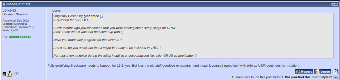

Looks like Pat is planning to move to Grub for Slackware 15.1:
From Linuxquestions.org

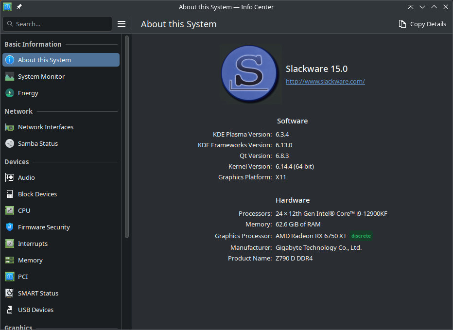

Since I've been tired of the old and stale in Slackware-Current, particularly Plasma 5 after being used to Plasma 6 in other distros, I decided to try the Plasma 6 binaries maintained by LuckyCyborg in the Slackware forums. I followed all the steps and everything seemed to work as expected, until it came time for startx. I got the initial Plasma loading screen with the turning gears, but it stayed on that screen for much longer than normal. Finally that went away and then I was left with nothing but a blank screen with my mouse pointer. I tested it with root just in case it was just corruption in my user settings but I had the same result there.So, I got XFCE working. I had installed it previously but it wouldn't launch at that time. It was just missing some dependencies and launches now. The configuration needs a bit of work but at least I have that. It's the latest XFCE released last December.
Re: Slackware-Current
I guess he's not so lucky :-)
Something might need a recompile (how current are they?) or it may be it's not being launched correctly. If you're just typing "startx" there would need to be a proper global xinitrc.kde with the proper command (e.g. launching it in a dbus session) and a symlink to it, xinitrc.
Maybe try making your own .xinitrc in your home directory, with the command:
exec dbus-launch --exit-with-session startplasma-x11
Thanks I'll give that a try. I used xwmconfig.
Hey that worked! I commented out what was already in there and added the 'exec dbus-launch --exit-with-session startplasma-x11' line below it:
