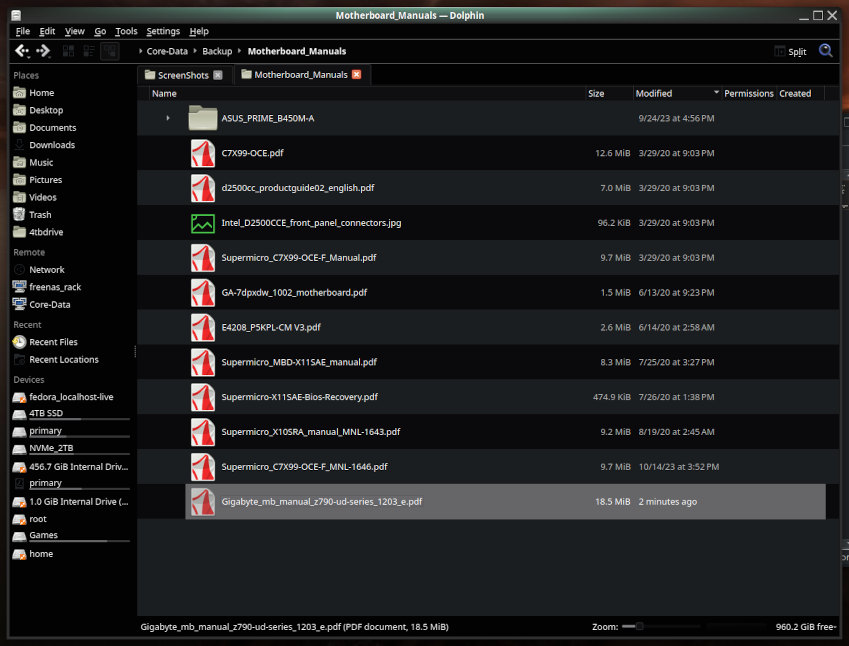

On my Arch gaming machine I've been running Mate, I use Dolphin for some things but it has always been tough to read file names because the alternating color pattern had poor contrast. It's been that way for a long time. But tonight when I opened it it looked completely different, it actually looks good now.

That does look good. I don't hate Dolphin as a file manager (I just don't like it lol). I mean, all of those file managers are too graphically confusing for me because I'm used to my X File Explorer for approaching 25 years (it was X Wincommander back then)
You should be able to change those alternating colours though, if not through a KDE interface, get something like "qt5ct" which is a configuration interface plugin that doesn't require KDE or anything to initialize it. You set an environment variable,
#! /bin/sh
export QT_QPA_PLATFORMTHEME=qt5ct
I just drop that in /etc/profile.d as "qt5.sh"
That application may be QT6 on your system now, so there's a corresponding "qt6ct" package and then you'd simply set the environment variable to QT_QPA_PLATFORMTHEME=qt6ct
In either case, set the environment variable and run the program, qt6ct or qt5ct. That program is only the configuration program, it doesn't run all the time or anything.

This:
Though I have to admit I hacked on "darker.conf" (/usr/share/qt5ct/colors/darker.conf if installed by Arch package, or probably /usr/share/qt6ct in that case) to get that jet black. You should too.
I don't have any KDE shit installed, just QT for applications, and without KDE there's nothing to configure it, so I use this.
That lighter dark grey you see there would be the alternating pattern in a QT based file manager.
