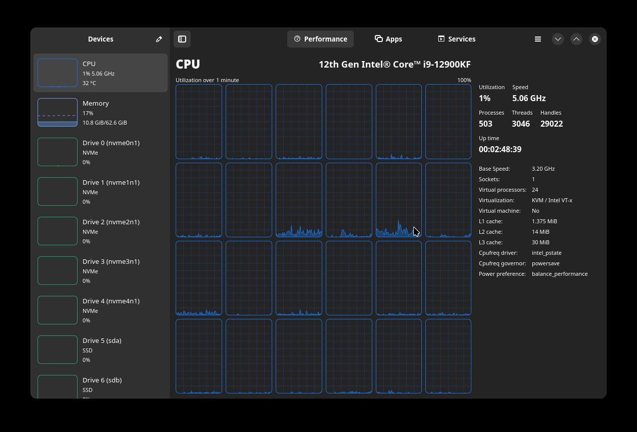

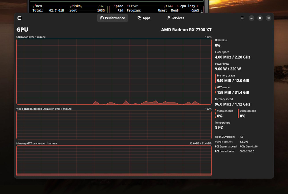

I heard about Mission Center and thought I'd check it out. I got it from the AUR. It looks nice with rounded corners. I configured it to show all cores individually. The side panel can be tweaked as well, like moving the network activity up above the drive monitors. Btop is still more efficient for this stuff but this one isn't bad.

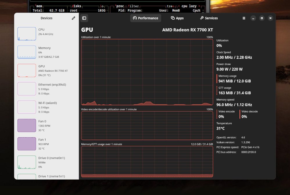

I tweaked the side panel to get everything above the drive monitors. It's now parked on the GPU monitor:

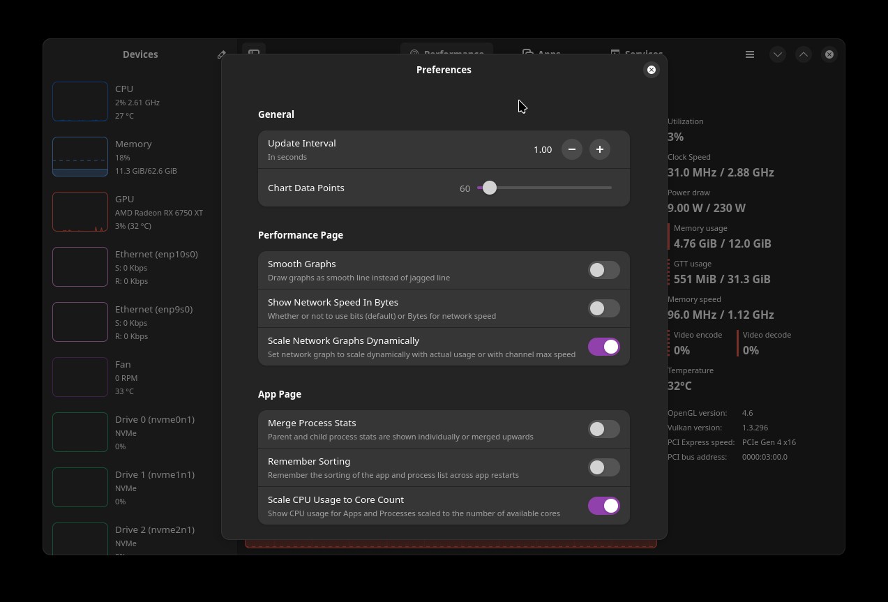

Yeah I like the GPU monitor, I thought it could be useful to have on my 2nd screen when playing a game. There is a setting in the preferences to adjust the interval:

I'm mostly interested in this for the GPU stats and that's working. The bottom slider for "chart data points" does what I want... I changed it to 300s so I get a reading every 1s and the chart shows 5 minutes of history.

I got it sorted out in MATE. It worked perfectly except for the side panel that remained white:
So for now I just untoggled the side panel, I might be able to tweak something in the css to get that working too:
I saved this as gtk.css in ~/.config/gtk-4.0/ (I already had a gtk.css file in that path so I backed it up before overwriting it):

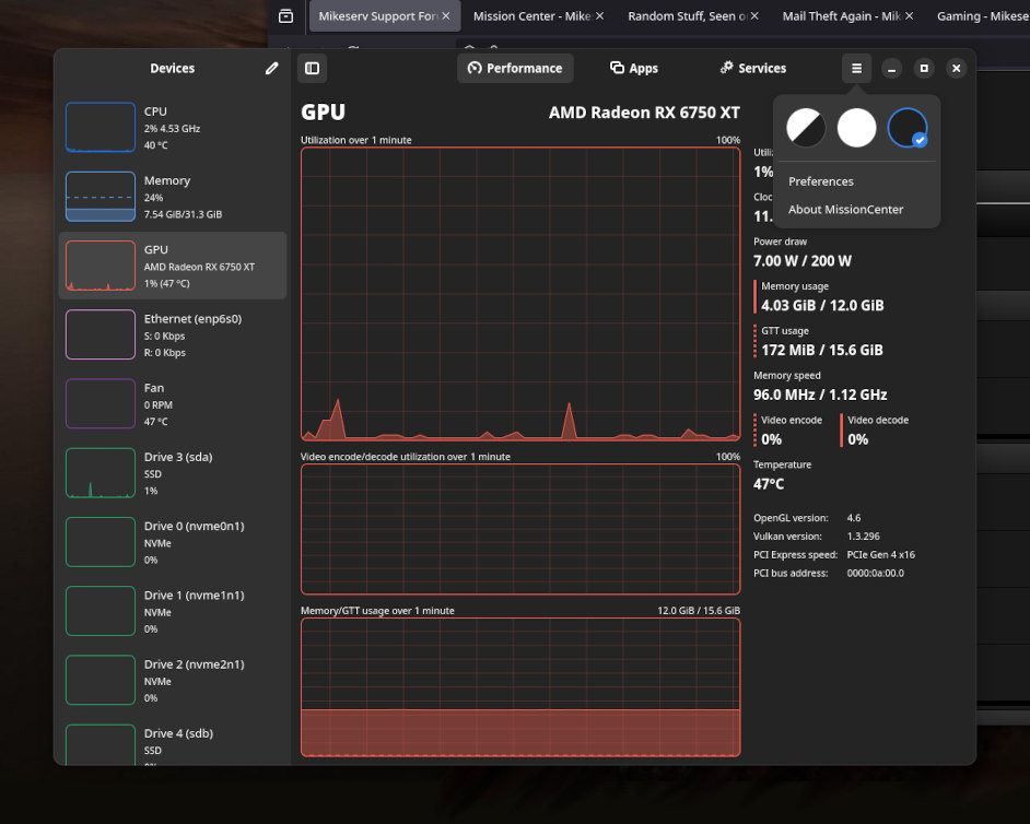

Decided to put it on my little downstairs machine which is also running MATE, and I noticed it had a theme setting:
I'm not sure what made the difference vs my upstairs MATE machine using the same css file.

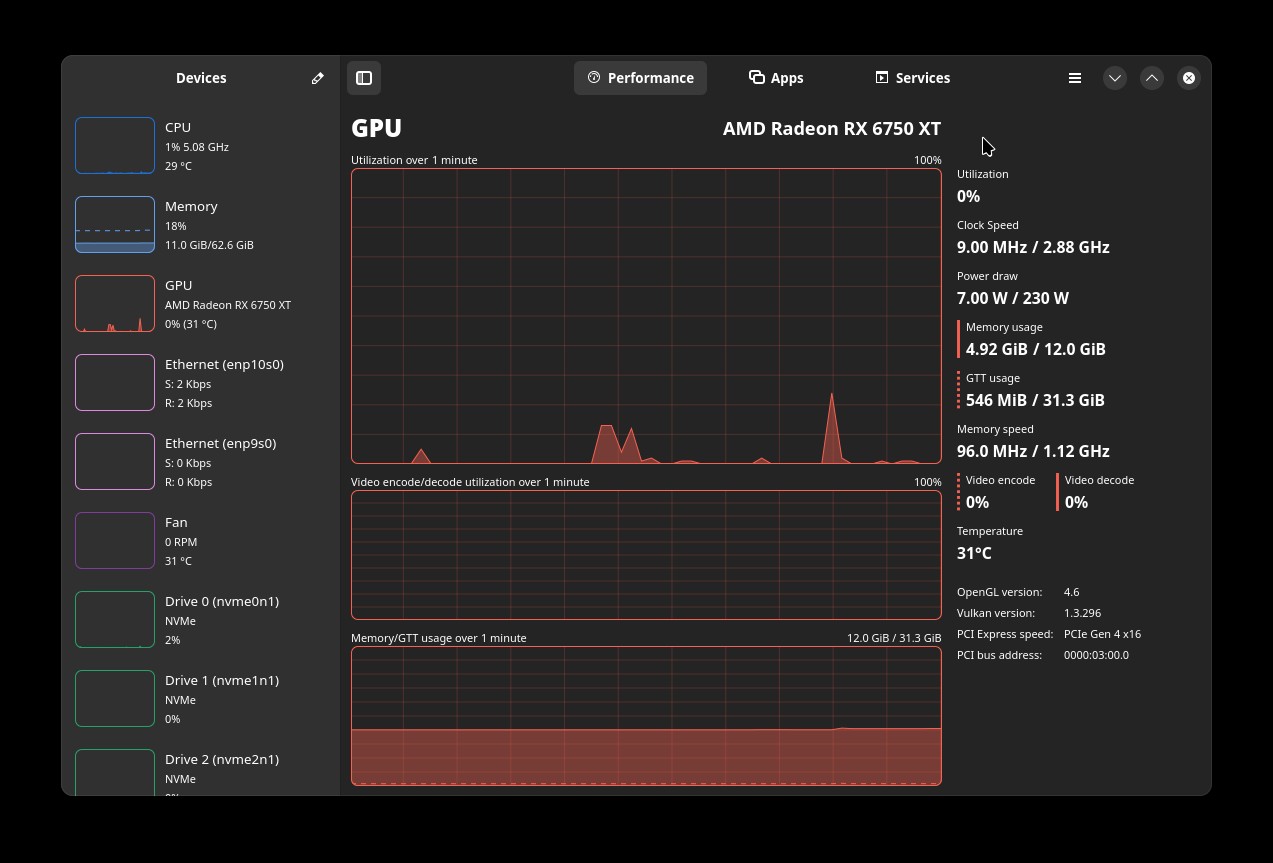

I got tired of screwing around with GTK4 so I settled on this, I'll just wrap it up in a script that I'll call "missionc" in /usr/local/bin
#! /bin/sh
GTK_THEME=Adwaita-dark missioncenter

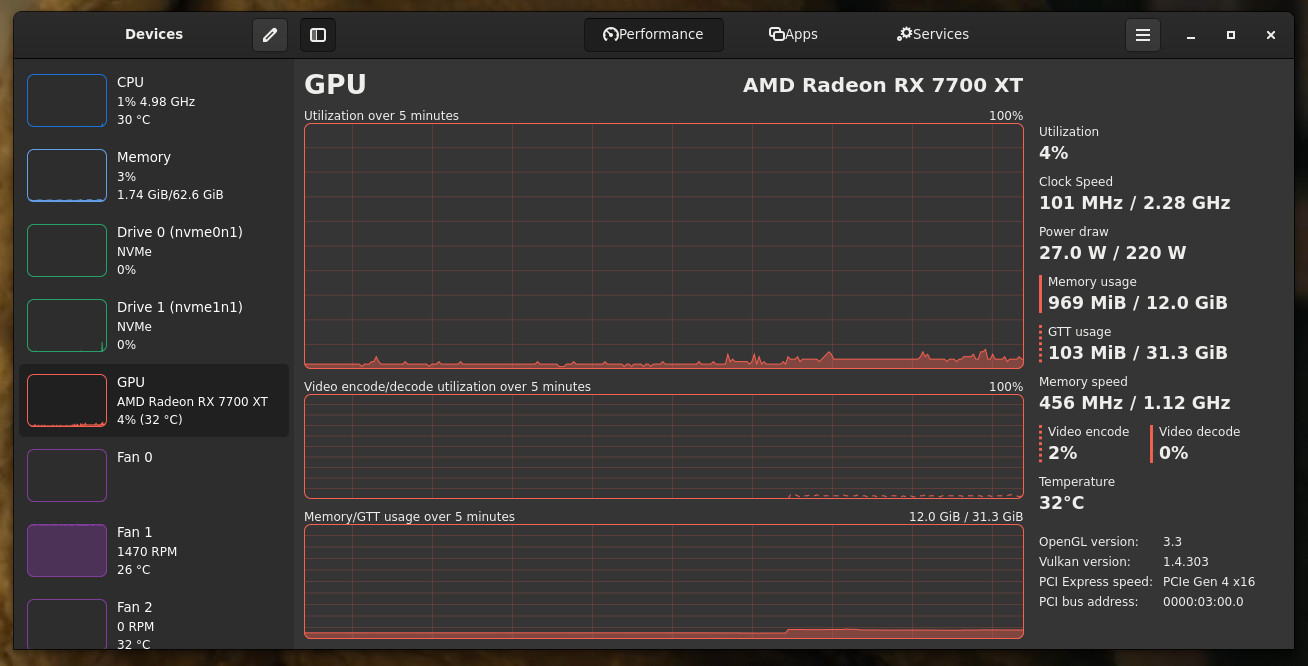

It's not exactly my favourite theme, but it's better than that white. This is what it gets me:

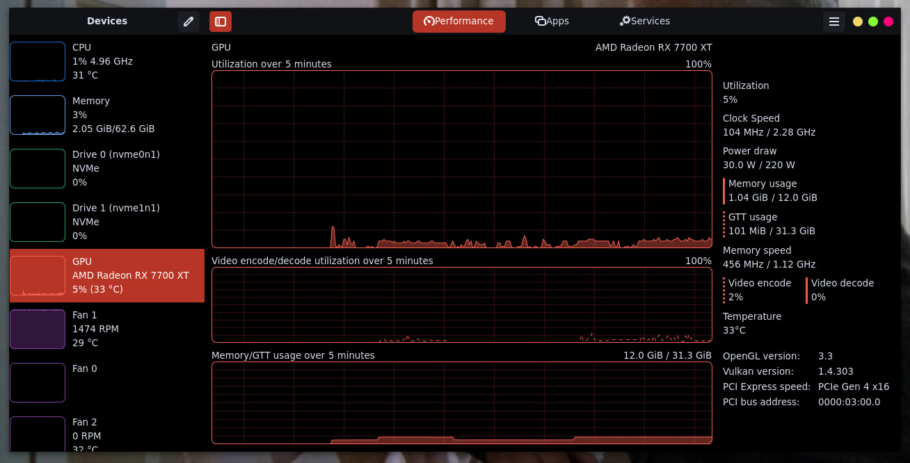

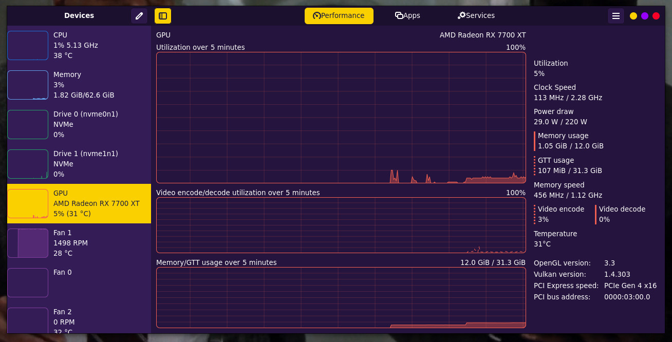

Alright, final screenshot. I knew I was never going to find anything perfect, so I found one called Andromeda that was close, and just edited the gtk-dark.css (and copied to gtk.css... identical) in the theme to use my #000000 and reddish-orange. I used the colour picker eye dropper in gimp to find the colour codes being used and find and replace in my text editor to change them.
Now THIS is starting to look good (I may still tweak some things). It works out well on the other screens too... Apps, Services
