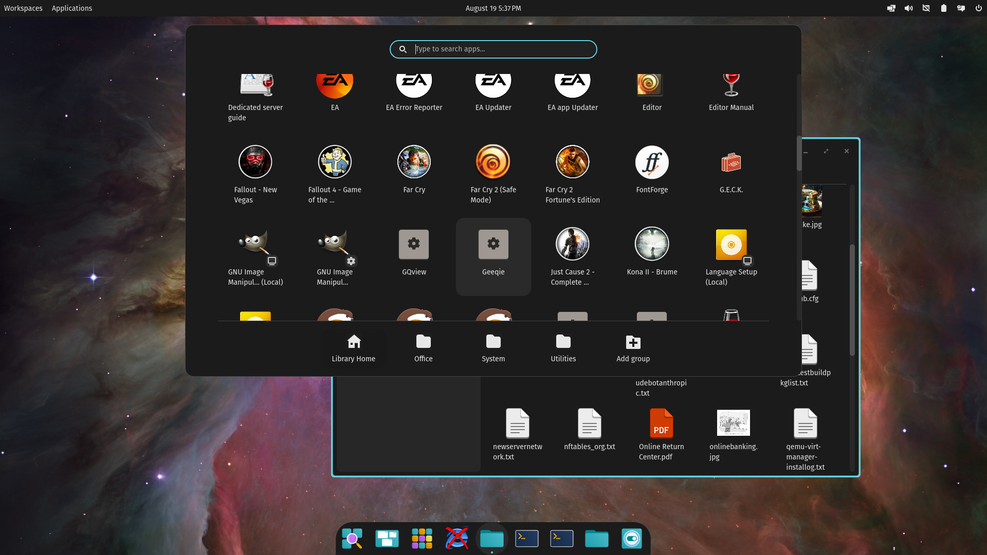

Right click and view this in new tab... looks OK, but I've got some work to do on that panel lol
By the way, I didn't put my Firefox icon on that Panel. It grabbed that from the .desktop file I have configured for it. That was rather nice of it, I was pleased to see it :-)

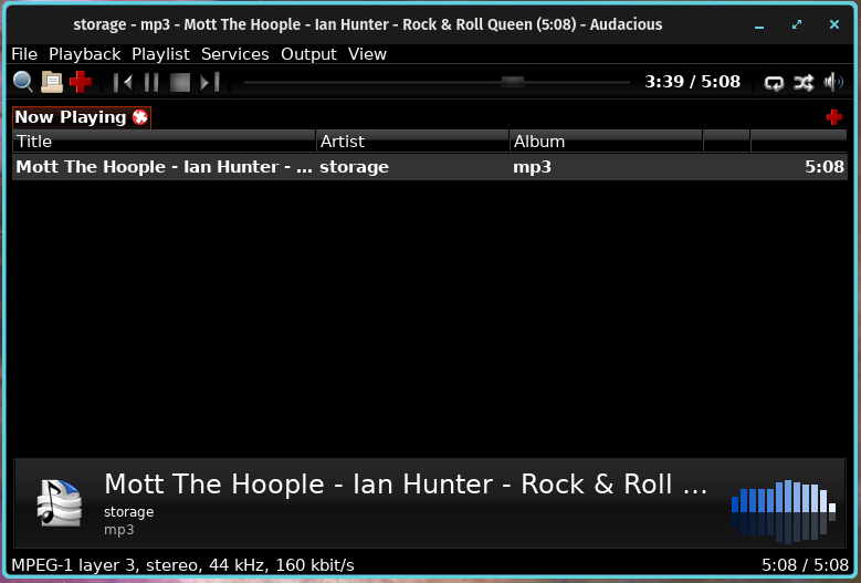

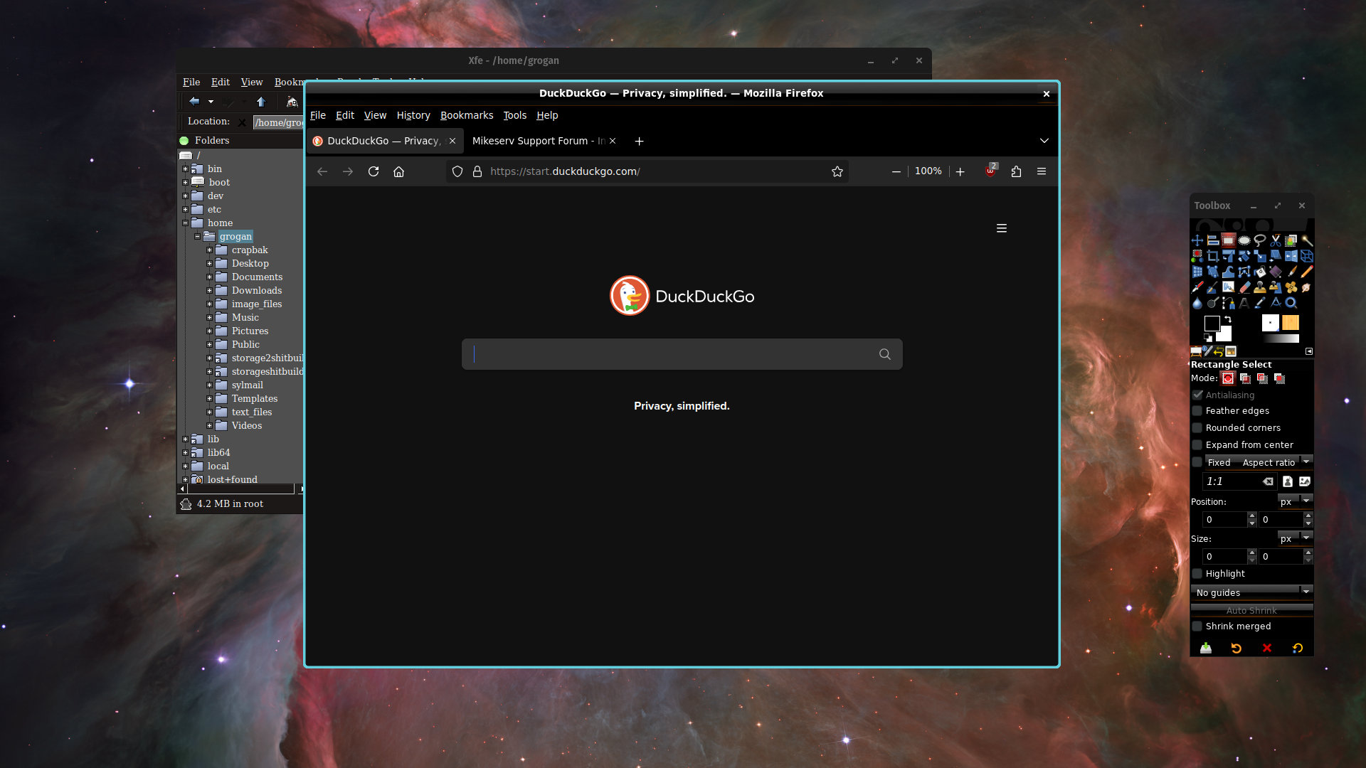

Now... this is the fuckery I'm having with my Firefox window decorations. I realized that what's happening is that it's confused into using my GTK style (my XFCE plasma-fire black with orange gradient style... not only in XFCE, but in GTK 2 and 3 config files). That's its titlebars, only a bit bigger (the size they'd be in cosmic) It seems cosmic can't replace that one. Other window managers normally use their own titlebars, whatever they are. Actually that's a good thing in disguise of a "bug"... it looks nice and I have very good right click functionality on titlebars to do anything I'd want and more anyway. I think I'll be sorry now if that fixes itself lol
Note in the image that other windows, GTK and misc. X11 like my XFE file manager all get normal titlebars (that look pretty good when active actually, the window controls get the colour of the blue outline... I quite like that)
I think the window controls are covered by the graphics that aren't supposed to be there :lol:

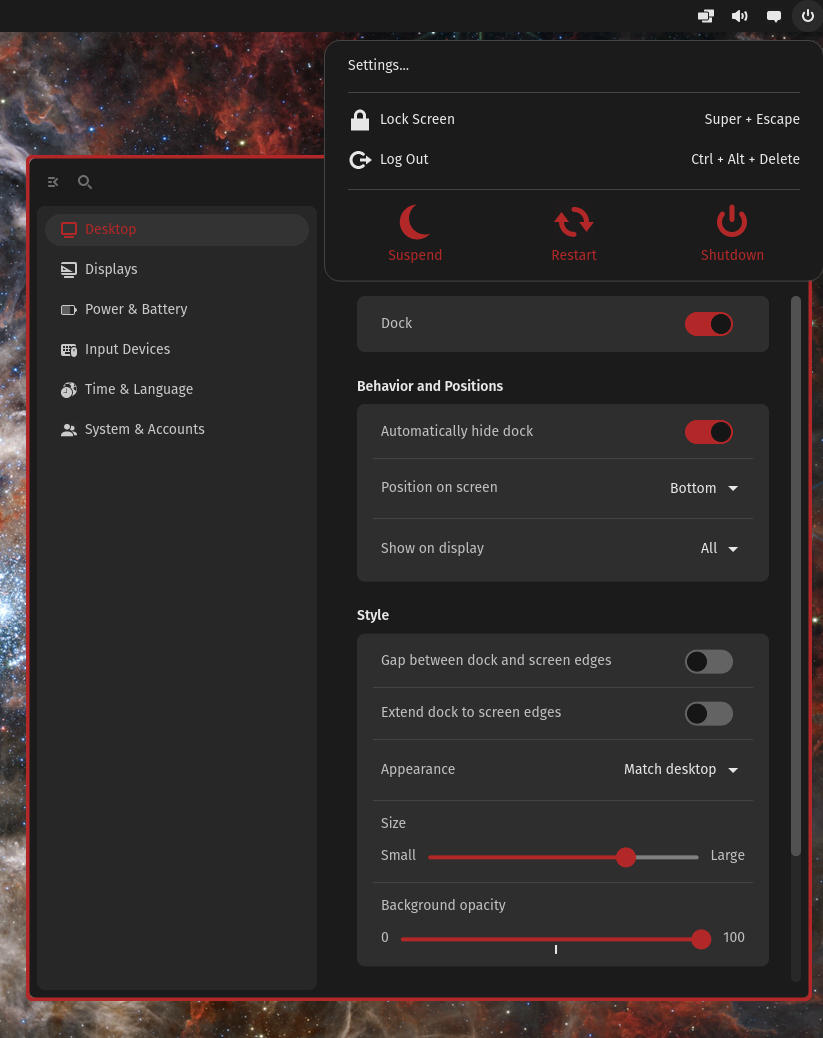

This is going to be a nice window manager, and that "dock" (to me it's a panel! lol) is nice. Minimized programs iconify and get an image preview for an icon and stuff.
P.S. Oops... my panel/dock didn't show up, because I set it to autohide. Oh well, I described it verbally lol

LOL... ever notice one of your mistakes in a screenshot? I just did, I just noticed out of the corner of my eye, from that image, that I had /local off the root. That happened when I manually installed audacious... I must have done "cp -a local /" (like I would if copying something through the /usr prefix) instead of "cp -a local /usr". The reason I didn't notice was that it was just an unnecessary recompile I was overwriting with and the application was working :oops:
That's a program I hate the way Arch builds, because they build it with QT6 and disable GTK. Why? (Jawohl!) That's not even how it's intended to be shipped, it can use either. I compile mine with GTK2 (--disable-qt --disable-gtk3) for the classic interface, and it looks really sharp with my GTK styling. It's supposed to be a little mp3 player like winamp/xmms not some bloated QT application. So in order to have this "little" mp3 player, if you install the distro package it's going to pull in that whole fat assed QT6 stack. So far I have kept QT6 off my system by compiling around it. I do need (and somewhat like) QT5 for some applications though.
This is what it looks like in Cosmic... this cosmic-screenshot program leaves something to be desired, but I don't have anything else that can take screenshots from Wayland. If you choose to capture a single window, it does it without titlebars. Best I can do is draw a selection if I don't want to do full screen and select. There IS a "Take Screenshot" in the right click menu on window titlebars, but it doesn't work (does nothing). That will be handy when they fix it though.
I like the rounded shapes in this DE. They can be turned off I noticed, but over my dead body :-)

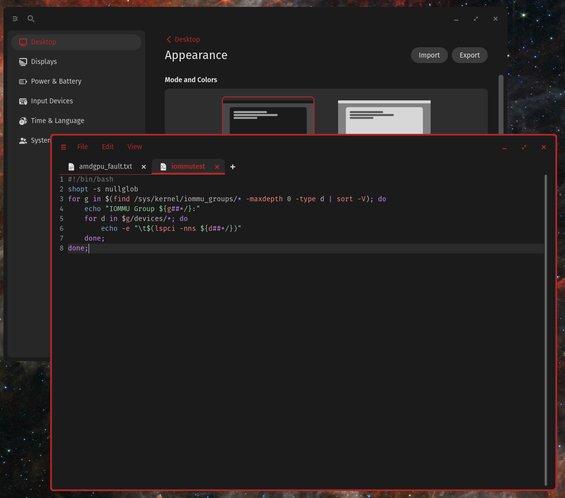

So that Cosmic text editor really didn't need oniguruma after all, it was because Arch was forcing it with -lonig in the PKGBUILD. I took that out and the text editor built without the package installed and seems to work OK. It might have more limited regex functionality because of it, but we'll see. I likely won't be using this text editor (I don't particularly like it or dislike it but I've been using a rather simple text editor from the FOX GUI toolkit for decades, and while it's nothing special, I'm used to it)

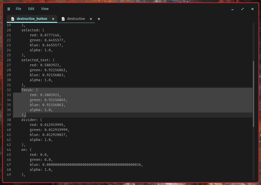

Now, while I'm making a screenshot of this text editor, I'll also show something about the appearance customization interface. It's rather limited at this time. While it will let me change the "Active Window Hint Color" (the outline around active program windows) it won't let me change much of the rest of the theme from the UI. Changing "Accent Color" didn't seem to get it. So I figure ehh... what else is new and went to find the actual configuration files. While it did populate them from $PREFIX/share/cosmic to my user config in ~/.config/cosmic, they are pretty miserable CSS-like syntax (miserable values).
All these things are coded for that baby blue colour in individual configuration files. The "Active Window Hint Colour" was just matching those. I want the rest of where that colour is used to be my reddish orange, but I'd have to find all the files that's configured in, convert the hex triplet to RGB and then convert to those RGBA decimal values. It's not hard (52 becomes 0.52 etc. and I'll use zeros for placeholders to keep their significant digits in case that matters to somebody) but it will have to be done in an annoying number of places.
Highlighted in that text file is that baby blue colour for the active window's "X" close button. That's just one thing, for that specific state, for that specific button lol
This is showing the file in /home/grogan/.config/cosmic/com.system76.CosmicTheme.Dark/v1
This is not nice shit to be editing by hand.
Re: Cosmic Desktop Alpha Release
There... how do you like the taste of my ass now, futhermuckers
Thinking about it, there was an instant way to do it. Because those values were so "unique", it was easy to find and change them everywhere they used them. So as not to be creating strange triplets with re-used colour values, I checked with grep -n first (line numbers) and those colour values were all used together in the files. I thought so, because for them to be that silly, they had to have been generated from some colour generator/wheel or something and they kept all the decimal places (lol! utterly pointless) and thus, would be part of a triplet. I really don't need all those (don't need to pad them, they haven't), my significant figures are 3
For one other element, they have it like this. That's just noise from whatever generator they used, it was meant to be 0 in the triplet (black, RGB 0, 0, 0 with alpha 1.0). That's how I'm sure the decimal places are bollocks.
blue: 0.000000000000000000000000000000000000000000036,
In case I get docked marks for not showing my work (I used to hate math teachers that did that):
From the focus setting for that destructive_button, I knew the values to change
These are the original values I want to change:
        red: 0.5803922,
        green: 0.92156863,
        blue: 0.92156863,
        alpha: 1.0,
My reddish-orange colour:
#B22727  = 178,39,39 = (convert from 255 scale to 100 (percent) then /100)
That means I want:
red: 0.698,
green: 0.153,
blue: 0.153,
alpha: 1.0,
Of course "alpha: 1.0" means opaque.
So, it's pretty simple to use sed with wildcard here because all the files are in the same directory
[grogan@nicetry ~]$ cd /home/grogan/.config/cosmic/com.system76.CosmicTheme.Dark/v1
(I already had these commands worked out in a text file, so paste... lol)
[grogan@nicetry v1]$ sed -i 's/red: 0.5803922/red: 0.698/g' *
sed -i 's/green: 0.92156863/green: 0.153/g' *
sed -i 's/blue: 0.92156863/blue: 0.153/g' *
That's it, awesome colours.

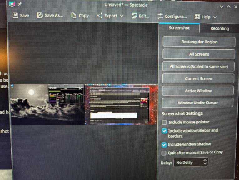

Actually the screenshot situation is pretty awful in Wayland. First of all, the only reason you have permissions to grab the screen at all is through xdg-desktop-portal. Secondly, not all Wayland screenshot programs work on all compositors. I just downloaded and compiled a few that looked promising. The first one called grim would have been a simple utility I could have just "sleep 10 && grim" and just position everything and have it capture the whole screen. Unfortunately this compositor doesn't have the method it wants to use.
So I download and compile another one only to find out that it's a front end for grim lol
The problem with the stupid cosmic-screenshot utility is that you have to bring up the program and operate it. This will DISMISS anything you had hovering or cause loss of foreground focus in the things you want to capture. It's very poorly thought out.
I wanted to show a screenshot including the buttons and sliders and stuff and my user session/logout thing and I just can't do it with that screenshot utility.

It's the same thing with making screenshots in Plasma 6.1 when using Wayland. What works there is to press the print screen key, and then up pops Spectacle. If you click the 'Rectangular Region' button it'll show you the desktop and let you select what you want to copy.
From there I can copy & paste into Gimp. There was no way to get a screenshot of Spectacle itself without using another utility (can't bring up another Spectacle instance) so I used my phone.
Yeah, it looks like you can set a delay there in that one. That's what I'm missing. "Capture the whole screen, including mouse pointer" after a delay of e.g. 20s and then get everything in position and hover over what I want etc. (That's how I'd use Gimp screenshot utility to capture things you can't keep on screen otherwise)
I can select a region, or get it to snap the screen, but only after a click, "capture", which then dismisses things like the logout area (I wanted to show my red/black buttons there, hanging down over the control center to capture that too).
You'll see what I mean when you get playing with Cosmic
Ahhh... the screenshot program wasn't working correctly last night. When it does a full screen, it draws a big outline around the whole screen before it snaps it. When that occurs, whatever was on screen seems to be there in the image and I can click Capture. That was not occurring. I should have restarted cosmic.
I tried it again today and now it's working like it's supposed to. I'd prefer a timer, but at least I can position shit before pressing Print Screen and it will be captured. This is what I was trying to do last night...

How to add things to the Dock...
It's easy if it's just an application that runs with no arguments. Simply open the application and then right click on its taskbar area on the Dock, and toggle "Pin to App Tray". Fine and dandy, but some applications are useless to just open with no arguments, for example a terminal application like my urxvt.
So I found where it stores those entries. I pinned my URXVT terminal, but it didn't take the arguments of course. I figured I'd manually add them to whatever source it's getting these from. It would pretty much have to be a .desktop file with the way it behaves (it gets my firefox icon etc. and those com.system76.CosmicEdit etc. are .desktop files in /usr/share/applications.
/home/grogan/.config/cosmic/com.system76.CosmicAppList/v1/favorites
    "firefox",
    "com.system76.CosmicFiles",
    "com.system76.CosmicEdit",
    "com.system76.CosmicSettings",
    "com.system76.CosmicTerm",
    "Xfe",
    "URxvt",
They seem case insensitive (there is nothing in all of Hell's creation named "URxvt"). However, that just opens the application with no arguments. I figure it has to be coming from /usr/share/applications so I edit urxvt.desktop but no. So on a hunch I copied it to ~/.local/share/applications, edited there and then just added "urxvt" to the list in that favorites array. I can't stand it being incorrect case like that. That's wrong, wrong, wrong of them. That should not be case insensitive, not only accepting but generating incorrect case.
[Desktop Entry]
Version=1.0
Name=urxvt
Comment=An unicode capable rxvt clone
Exec=urxvt -bg black -cr green -fg white -C -fn 9x15 -sl 3000 -ls
Icon=utilities-terminal
Terminal=false
Type=Application
Categories=System;TerminalEmulator;
That worked, now "urxvt" on my Dock panel launches my terminal correctly.
Anyway, if you want some application, make a .desktop file configured to your liking in ~/.local/share/applications and add the name of it (without .desktop extension) to that array in that favorites file :mrgreen:
P.S. It gets some applications absolutely wrong, so careful with that. I went to pin my favourite text editor "Adie" (/usr/local/bin/adie) and it added it as Unknown Application 28 and gave it a wine icon. At first I thought it just chose an icon wrong so I clicked it and it tried opening nothing with wine (generating prefix but it aborted and didn't create ~/.wine). I have no idea why it tried to run what would have been "Unknown" with wine lol
If that happens, fix it manually as shown. I added it as adie in that favorites file array and it worked because I have an "adie.desktop" in ~/.local/share/applications configured with the icon "text-editor" so it's perfect on my Dock. It must have been unable to grab the application name from the process and consequently didn't find adie.desktop that was already there.
P.P.S. Icons. You can specify an absolute path to an icon in a .desktop file. OR, this will find them in ~/.icons (which is the old school location for them). Otherwise, to reference an icon by name like that, there would have to be an alias or a symlink in the icon theme that the environment is using.
Currently, there's an "Experimental" settings panel in Appearance that lets you change the icon theme. I don't want to find out how that works out, because I see they don't have to be valid to show up there. I have incomplete icon sets that I use icons manually from BUT also things like cursor themes show up in there and they are NOT icon sets (moreover, there's no xcursor support, you're getting the cursor from the environment except in things that support it directly, for example Firefox through my GTK+ styling). So I'd expect icon themes to not jibe at this time. Probably icon aliases aren't all worked out, which is why it's "Experimental".
For example, I added Sylpheed to my Dock and there was no icon for it. I never noticed before because I always assign my own icon to it, but there actually is no icon named "sylpheed" as the shortcuts are configured (some icon themes, older ones, do have one for it).
So I took my email icon and resized it to 48x48 as used on the dock (I don't like having icon images automatically downscaled every time they are drawn, why do that work). I stuck it in ~/.icons and referenced it as simply Icon=email in the sylpheed.desktop file.
I knew this because my Firefox icon has "noie" as the icon, which the only place that would be automatically found would be there, where I have a "noie.png". That's the only firefox.desktop file configured with "noie" the one I manually use in ~/.config is named "ie.png".

LOL... I found a pretty strange bug. After finally getting my urxvt dock entry to launch my terminal with the arguments in the .desktop file, I noticed that sometimes the terminal would start scrolling enter repeatedly, very fast. Hitting the Enter key stops it.
Then I figure out that it doesn't happen the first time it's launched, but does each subsequent time. Hitting Enter stops it.
I also noticed after that, my XFE file manager launched from the Dock does the same thing. The directory view keeps refreshing over and over while the mouse cursor flashes briefly to busy and back. Again, hitting Enter stops it. That area shouldn't even be in focus like that until something is clicked in the pane.
It is because of the way I quit my terminal, my hands are on the keyboard while using it and when I'm done, I type "exit". This kills the shell and the window, I've been doing it like that for 25 years.
If I quit my urxvt terminal by clicking the X ("destructive_button" lol) this doesn't occur. I can repeat it over and over and it doesn't happen if I kill the window with the X. Then, my XFE file manager doesn't act up either. It must be the way something is terminated when passing execution through the Dock or something in this desktop, when I kill that shell but the window resource isn't killed it must keep perpetuating the Enter command in the background, to new subshells the Dock launches programs in. So I have to remember... When in Cosmic, use the X (that's going to be a hard habit to break as it makes opposite sense) :lol:
P.S. I'll bet this also explains why my keyboard suddenly stopped working last night. It was indeed after having that bad behaviour occur (and little did I know at the time, it was still going on in the background). I was typing a post here and suddenly no more keystrokes. I clicked somewhere else, and the keyboard started working again briefly in a text editor but then stopped dead there too. It was also accompanied by the green light on the keyboard coming on (like if it's been powered down and powering on from a keystroke). Even after I quit Cosmic the keyboard was dead on the root console. I went upstairs and got some new batteries, but still the keyboard wouldn't work. At that point all I could do was an ACPI power button shutdown and the keyboard worked again after booting up. The receiver must have been in a bad state or something (in that case unplugging and replugging probably would have worked also). The mouse on the same receiver was working though.
