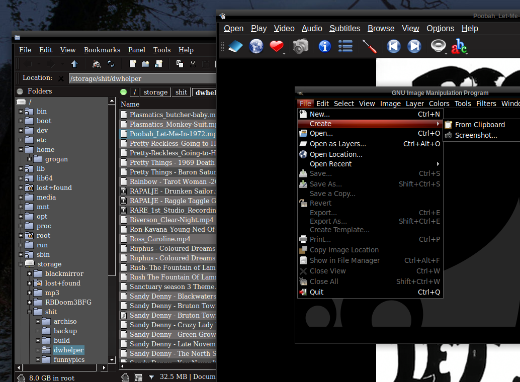

Wow, did I ever get my fonts looking nice here, even better than Arch or my LFS. It kind of looked like shit, with Gentoo's defaults so I ran
You have to use that to configure your symlinks in /etc/fonts otherwise gentoo will overwrite them.
I disabled 10-subpixel-none and enabled 10-subpixel-rgb and 10-hinting-slight and that's all I did. 11-lcdfilter-default was already enabled.
I'm going to have to see about duplicating this exactly on Arch (I thought it was)
I'll have to use PNG for this, hope it looks this good in the image on this display
Note that the picture is showing 3 different mechanisms at the front end. The FOX gui toolkit (which uses XFT directly) in my file manager, QT in my SMPlayer, and GTK with Pangoft in Gimp all running under XFCE's font settings overrides. It all looks sharp.
eselect fontconfig list
