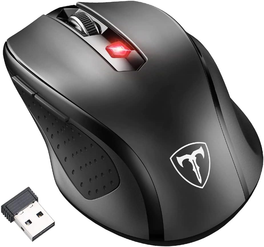

I missed your last post about that mouse, it looks like a nice one.
