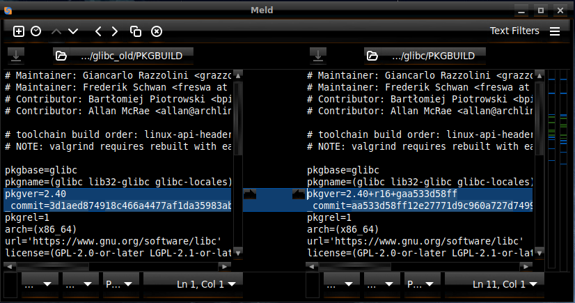

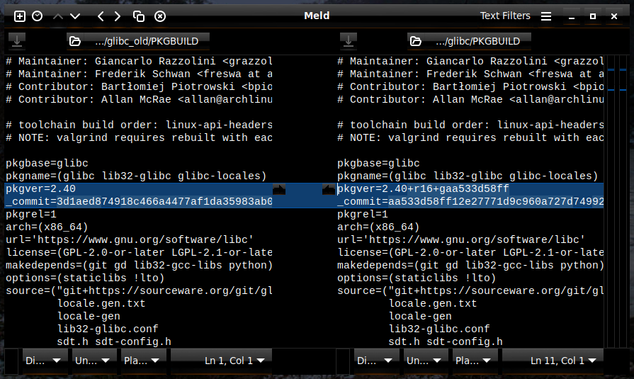

I'm not sure how this happened, but their packages have a c in the git version string. (gab884fffe3f-1 vs. gab884fffe3fc-1
[nicetry ~]# pacman -Syu
:: Synchronizing package databases...
 core is up to date
 extra is up to date
 multilib is up to date
:: Starting full system upgrade...
warning: gcc: ignoring package upgrade (14.2.1+r134+gab884fffe3f-1 => 14.2.1+r134+gab884fffe3fc-1)
warning: gcc-libs: ignoring package upgrade (14.2.1+r134+gab884fffe3f-1 => 14.2.1+r134+gab884fffe3fc-1)
warning: gcc-rust: ignoring package upgrade (14.2.1+r134+gab884fffe3f-1 => 14.2.1+r134+gab884fffe3fc-1)
warning: lib32-gcc-libs: ignoring package upgrade (14.2.1+r134+gab884fffe3f-1 => 14.2.1+r134+gab884fffe3fc-1)
warning: libgccjit: ignoring package upgrade (14.2.1+r134+gab884fffe3f-1 => 14.2.1+r134+gab884fffe3fc-1)
warning: lto-dump: ignoring package upgrade (14.2.1+r134+gab884fffe3f-1 => 14.2.1+r134+gab884fffe3fc-1)
 there is nothing to do
I just built and upgraded my gcc packages. Obviously it's the same version string, but theirs has an extra character. First time I've ever seen this. Harmless, but untidy... I've been trying to keep those version warnings to a minimum (it's irritating to have a long list... that's not all of it, I snipped some just to show the gcc packages)
It could be a case of packagers not eating their own dogfood... I used the latest PKGBUILD and my edits don't touch that in any way. It's obtained like this:
pkgver() {
  cd gcc
  echo "$(cat gcc/BASE-VER)+$(git describe --tags | sed 's/[^-]*-[^-]*-//;s/[^-]*-/r&/;s/-/+/g;s/_/./')"
So... the packager likely has something different in that sed command.

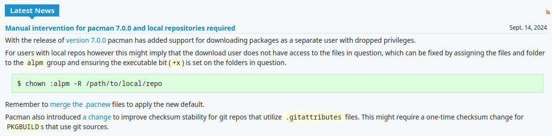

Arch news:
Posts: 2250
Re: Arch Linux 2024
That's stupid... it still needs root to install them. If I want to "download" packages as an unprivileged user I could use fucking wget. Arch spinning their wheels...
I don't have any local repos, so that doesn't affect me, but it irritates me that shit would be owned by another user. That's not even the problem, reading between the lines there, it also means they are setting restrictive permissions.

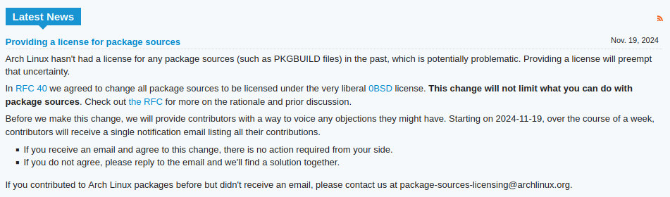

Arch news:

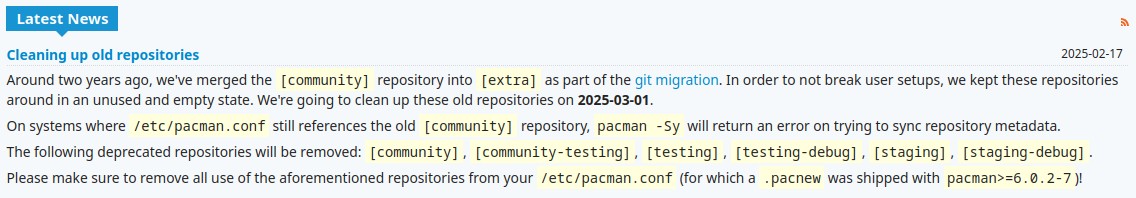

I had no community repository entry on my main machine but I did on my game machine.
Posts: 2250
Re: Arch Linux 2024
I was just checking mine and I couldn't find /etc/pacman.conf. That's because I forgot I'm in Gentoo :lol:
I mounted and checked it and mine is modern enough that I don't have those old repos. That would have been last March when I built this system. I really should check for changes to merge, but I don't like the things they do and end up commenting out their shit anyway.
Posts: 1251
Re: Arch Linux 2024
That's something I've done before with multiple distros installed lol!
Yeah I installed Arch on my game machine before that change so that would be why it still had that repo. I still have to check the one downstairs, I forget when I installed it there.
