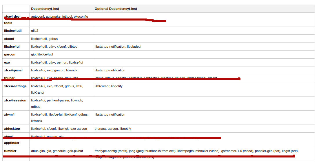

Some of that is going to get put back, but the less of it I can muster, the better. A lot of that junk is because of Thunar, which I hate and I don't normally build. It isn't a dependency for any other XFCE components if it isn't there when building them (there will be a harmless "file not found" when xfce4-session tries to execute it though). There's no USE flag to avoid it, at least not in the meta. If this build system won't let me build XFCE without Thunar, then it's going in /opt by hand. I want to ditch all that gnome gvfs and udisks2 related junk.
The actual, mandatory dependencies for XFCE are not onerous at all, and you don't have to build all components of it
https://docs.xfce.org/xfce/building
For me, that's just this (and without most of those optional deps). I won't be building those things I drew a (messy lol) line through.

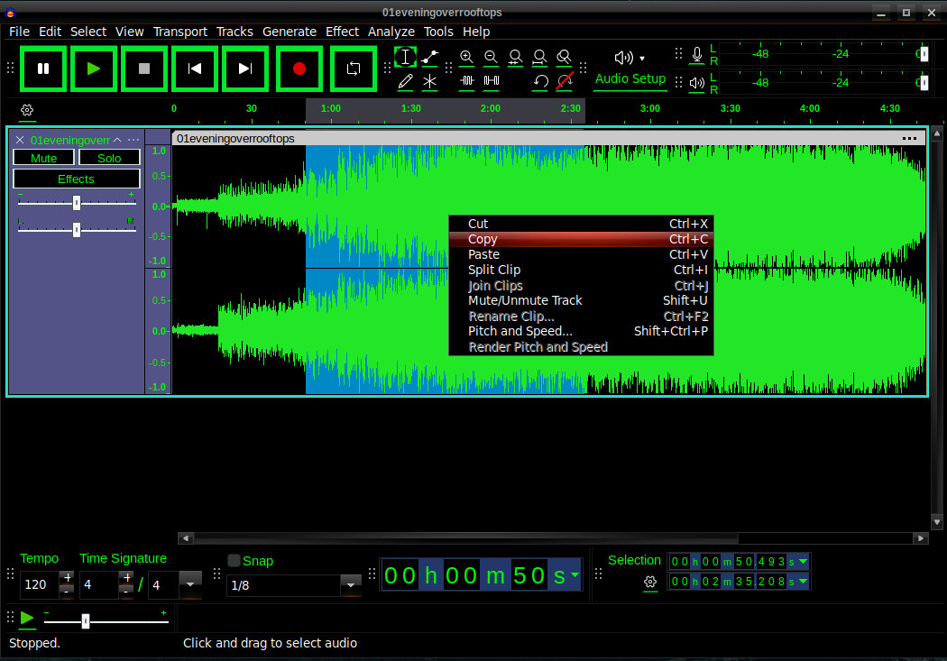

Sometimes, you just have to ask yourself, do I really want this application? The whole point of this system was to keep the dependencies to a minimum. I've not (ever) installed Audacity on Arch because it would pull in too many unwanted dependencies. Gentoo is a bit better, but all the same I don't think I'll do this.
I'll go and grab the Audacity git tree which (hopefully still) has everything necessary bundled for an in-tree (mostly) static build, including appropriate sources for that WxWidgets crap, which Gentoo is MacGyvering with eselect and install it the old fashioned way. I did a build like that on my LFS, so I just used it there when I needed to edit audio. But now I don't have that LFS system on this computer anymore. This build will likely run on my Arch too.
nicetry ~ # emerge --ask media-sound/audacity

So yeah, it's as simple as that. The build process of Audacity has changed a bit since last time I did this, they now use this "Conan" build tool (automatically, during the cmake command based on preference) to satisfy dependencies before the build.
I'll just paste the notes I made as I was going along, this was super easy to suss out. I did not have to install one single thing on Gentoo (any system set up for dev will already have prerequisites) to pull this build off. The key to this is -Daudacity_lib_preference=local so it uses everything bundled in the git tree instead of system libraries.
# not sure if --recursive is necessary here, but I do want any submodules if there are any and it doesn't hurt if there aren't, so...
git clone --recursive https://github.com/audacity/audacity.git
# from above audacity source dir
mkdir build
cd build
# build process has changed, it uses this Conan thing to build your deps during the cmake command here:
# Release build already does -O3, so don't add -O to flags. With all the shit this has to build, put the -Wno-errors for gcc 14.x)
cmake -G "Unix Makefiles" ../audacity -DCMAKE_C_FLAGS:STRING="-march=alderlake -Wno-error=implicit-function-declaration -Wno-error=incompatible-pointer-types" -DCMAKE_CXX_FLAGS:STRING="-march=alderlake" -DCMAKE_INSTALL_PREFIX=/opt/audacity -DCMAKE_BUILD_TYPE=Release -Daudacity_lib_preference=local
make -j?? (-j24 is yet to be determined but it only took about 3 minutes with -j4 since the deps were already built)
make install DESTDIR=/storage2/test
find /storage2/test | xargs file | grep -e "executable" -e "shared object" | grep ELF | cut -f 1 -d : | xargs strip -p --strip-unneeded
So then, for continuity... this is how I installed it (as root now). I don't really need to copy through /opt here so I won't.
(examine directory tree, yep, just /storage2/test/opt/audacity and nothing's going to get clobbered, it's going to use lib64 and didn't create a "lib" dir etc.)
chown -R root:root /storage2/test/opt
cd /storage2/test/opt
cp -a audacity /opt
(I generally don't trust make or ninja installs anymore, always to a DESTDIR first... I want to see what it's going to write and I'll install those results manually with "chown -R root:root" and "cp -a" if not packaging)
This needs only to be found in $PATH (or /opt/audacity/bin/audacity run explicitly... it's actually the only binary... 19.4 Mb stripped for me). You do not even need a ld.so.conf entry for /opt/audacity/lib64 here because it installs all its own bundled libraries in its own lib64/audacity and finds them there)
Moreover, while I don't personally like to do that, I see no reason why this couldn't just be installed to a user owned directory and run like this. (A user can set their own PATH or just run this from location)
In a few minutes... et voila... a fully functional Audacity without installing anything else on the system. It will probably run for years, too. I tested a .flac file first because that's what I'm likely going to be doing next, chopping, tagging, exporting to mp3 for the car. Having some flac I want to chop up and being unable to was what prompted this today.
(That's the built in High Contrast style I chose. Except for the mind searing green, it matches my GTK styling the most. Fonts etc. a bit blurry because the image was 1050 px and gets downscaled by the client. They seem to have taken that setting away in current phpbb, probably proportional to client window geometry or something now. At least it doesn't alter the images for viewing in new tab or saving etc. like some boards do)
