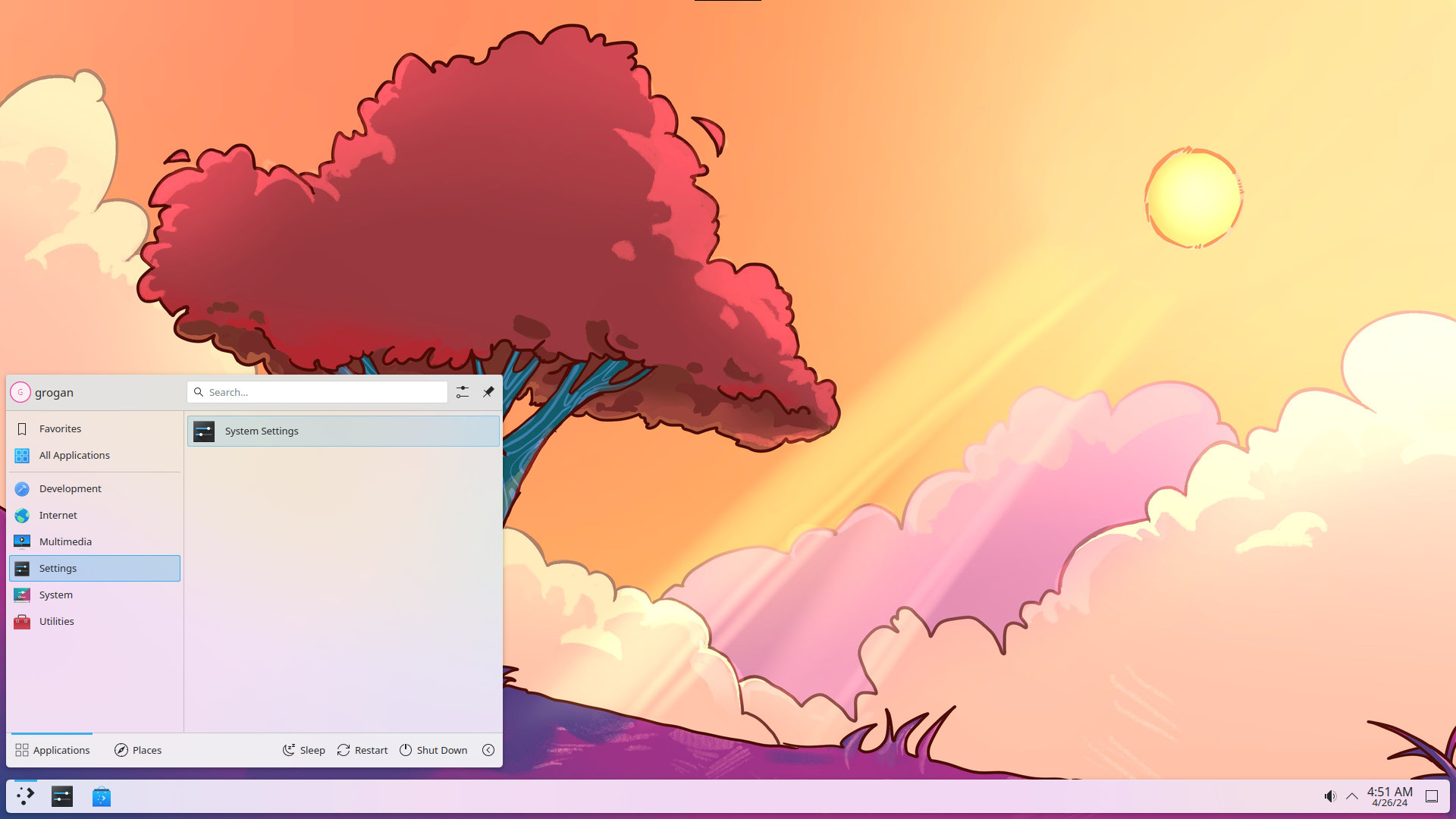

Re: Arch Linux 2024
Since I'm not gaming anymore on this computer (and hence, will not have focus problems with games) I'm back to my beloved TDE now. The last time that (and TQT3) was recompiled was around 2 years ago (and it still runs transplanted on the new computer) as parts of it got subtly broken once on Arch. I could upgrade it, but I've learned that when you're happy with something old, and it still compiles, use the same sources (and don't try to recompile it again unless there's a reason because it might be a pain in the ass) :-)
It sure is nice to be using this, with my all black, rounded Keramik style and all. Beautiful big panel and desktop pager (I use a 2x2 square configuration)
