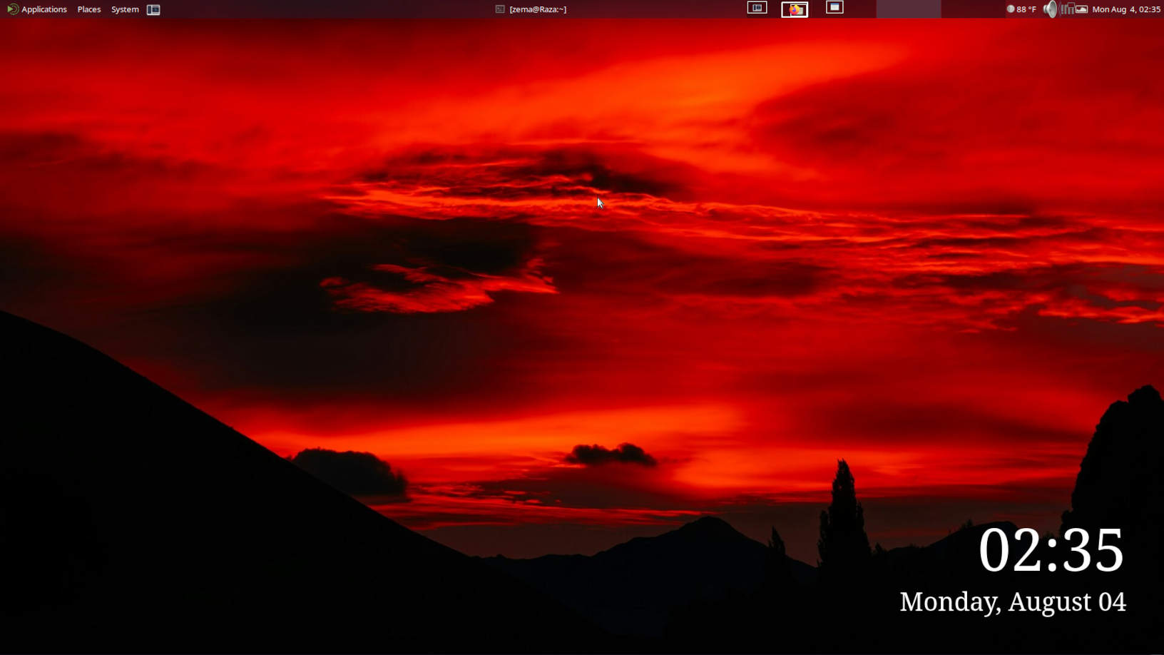

I booted into MATE in Arch (vanilla Arch originally with just Plasma) and configured MATE
Re: Arch Linux 2024
That's a super nice wallpaper.

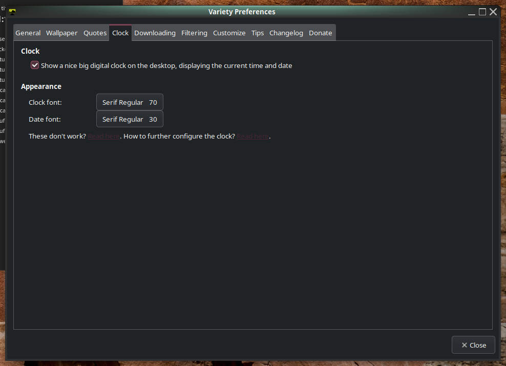

Does that clock overlay on your desktop like that all the time? It also looks good (nice font).

It does, as long as Variety is running, I have it set to start with my session.
Here's what the clock settings look like:
