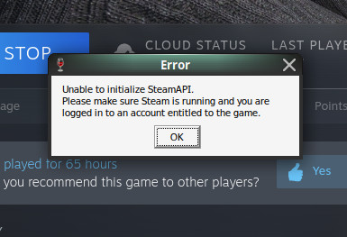

Where there any issues and workarounds I might have missed since the Sniper Elite 5 patch late last year?
I was going to get a quick game in but instead I got this:
I ran into that before but I can't remember the details or how I resolved it.
Posts: 2363
Re: Proton and Wine
No, there haven't been any problems like that with Sniper Elite 5.
Maybe try checking integrity/repairing the game? It sounds like its Steam integration dlls could be borked or something.

Ok, I'll do that. Sniper Elite 4 launched so I played that for a while last night.

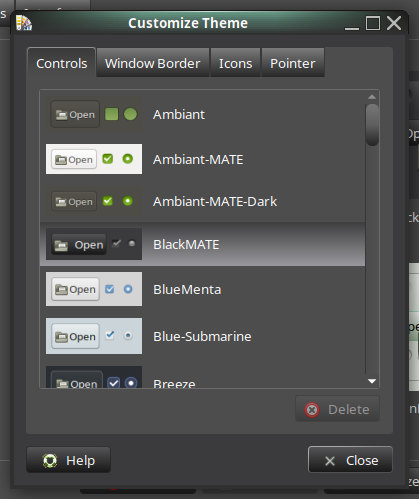

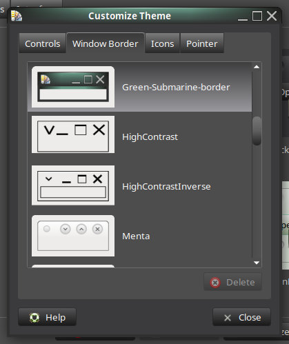

I noticed something in your screenshot, the green gradient titlebar on that error dialog. Is that your window manager's window decorations? (KDE?). I quite like that.
Posts: 1346
Re: Proton and Wine
Oh yeah that's from the MATE desktop theme I cobbled together :) I forget what the name of the theme the titlebar came from, submarine something.

It's a really nice gradient and titlebar text. Sometime when you're in that, can you make me a screenshot with some windows open (e.g. foreground and background)?
When you get to fixing Sniper Elite 5, try the verification first, and if that isn't the issue, next try copying the game data away and deleting the prefix. Run the game once, get to the menu and quit and copy back your data etc.

I combined two different themes, BlackMATE for the controls and Green-Submarine for the window borders. There's also a Blue-Submarine variant. I could probably get it darker overall. With a dark theme and dark background it kind of looks like there's a florescent bulb in the window decoration or a light shining on it :)
Sniper Elite 5 is working now, the file integrity verification found no errors. I backed up and deleted the prefix and tried to launch it again, but I still got that error, and it popped up after the initial launch settings window but before the game launched, so it never created a new prefix. I even went so far as to uninstall / reinstall the game to no avail. Then I checked to see what Proton version it was using, and it was on Experimental, so I set it to 9.0-4, and on launch it asked about enabling Easy Anticheat, I usually keep that disabled but I enabled it just in the off chance that had something to do with it. But it launched normally after that.

That looks awesome. It's all puffy looking like Keramik (my favourite style in KDE 3). Very nice rounded corners too. I'd make the black 000000 though :-)

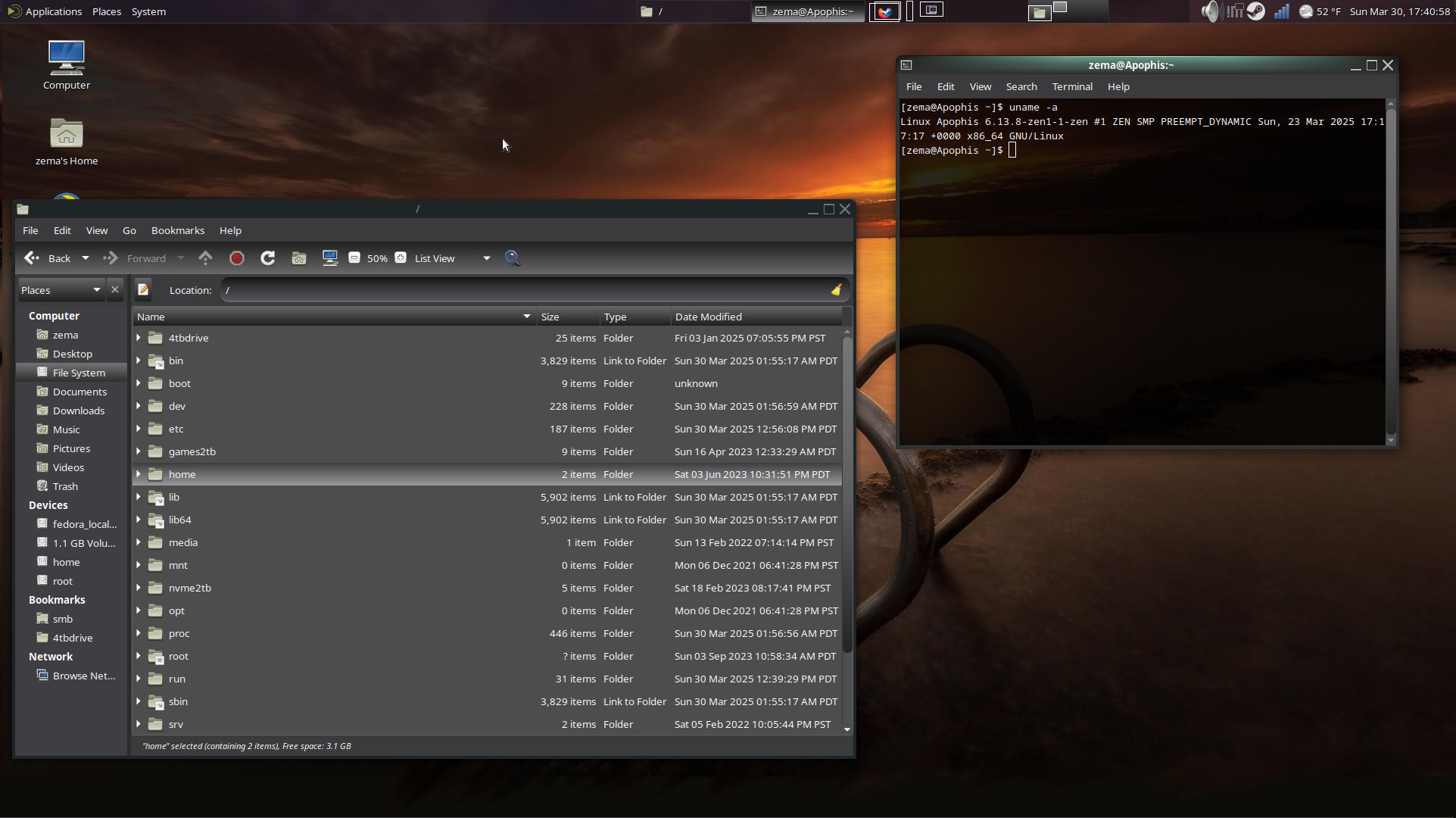

I must have missed the post above. The garbled audio, was that with Linux 6.14? You can only do it from the settings on the launcher (it's not there in-game), but setting Audio Reverb to Off should fix that. I had it in Sniper Elite 4 as well, but I think increasing buffers fixed it there. I have it disabled in all those games (except for testing).

Yeah, right after installing 6.14. I got the garbled audio in Sniper Elite 4 a few nights ago but not last night. Thanks, I'll turn that off next time I launch it.
