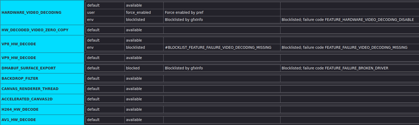

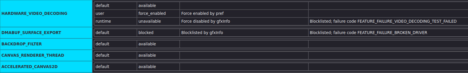

I still don't have hardware video decoding working on Gentoo. I rebuilt my ffmpeg with the vaapi USE flag. There must be something else missing support for it that I'm not aware of. It can't be firefox (same build, common location). My mesa is built with gallium va support too.
Not that it matters, I couldn't tell the difference in youtube video playback on this system. Maybe on the old one it might have mattered. All the same, I want that working. It is in Arch, despite the spurious shader cache errors (this shouldn't be caching shaders in the first place).
See the difference in about:support output. Those accelerated codecs don't even show up in the gentoo output because the video test fails.
This is Arch, where it's working
This is in Gentoo, where it's not working. Note the first difference, where it says "runtime" disabled, and then shows a test failure. It then doesn't enable any of the supported hwaccel codecs.

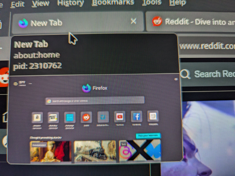

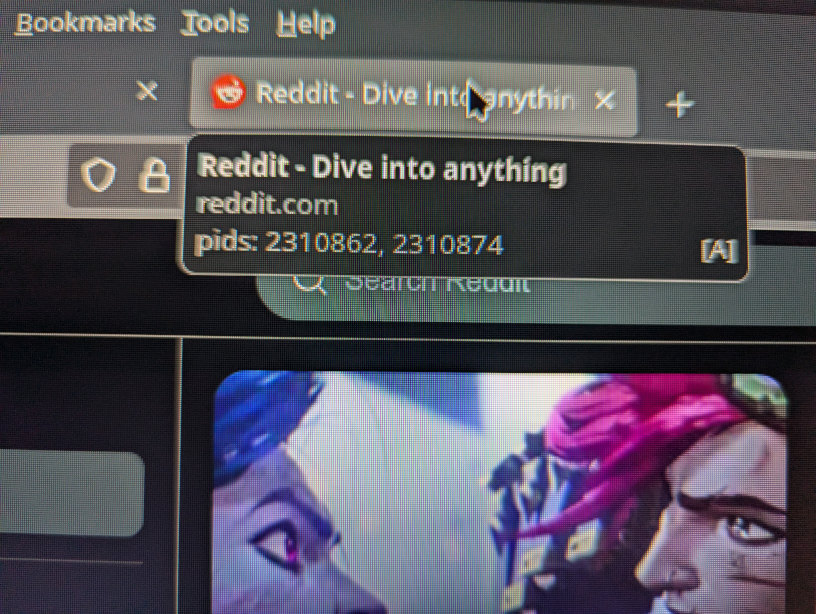

Posts: 1320
Re: Firefox and Librewolf
One thing I noticed in Nightly is it shows the pid when you mouse over a tab. That may just be a developmental thing but it was interesting to see.
Posts: 2320
It must be for debuggering purposes... it could be useful info if you want to see what the process is doing in the process list.

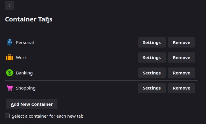

Posts: 1320

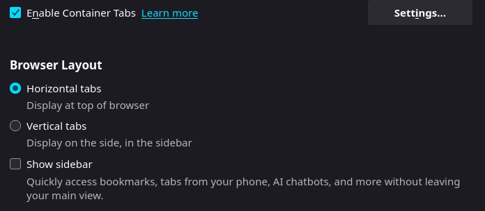

Some new settings in Firefox 137 Nightly (introduced in Firefox 136 from what I heard):
Here's the settings for the container tabs:
And here's what the "Learn More" link links to.
