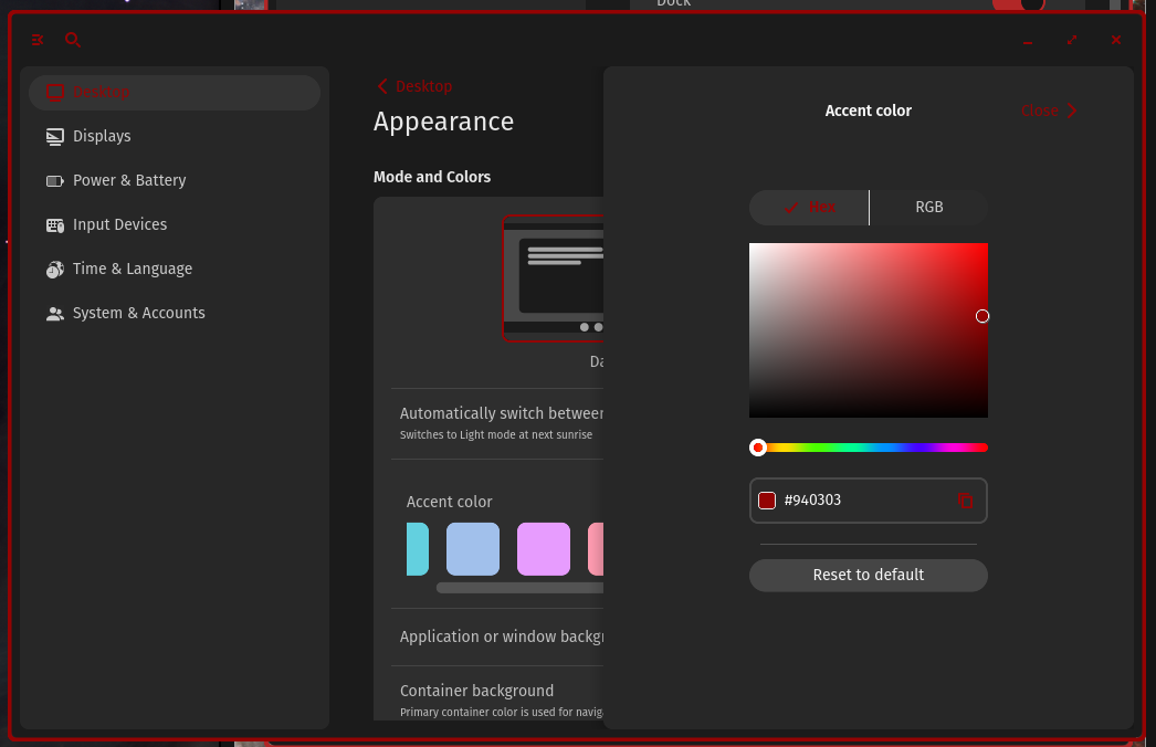

I may have missed it in the thread, but did you come across the color settings in the Cosmic Settings?
Re: Cosmic Desktop Alpha Release
Yes, but the Accent colour didn't change it. I clicked + to add one and it just reverted back to the blue. So I forced my colour in the config files.
The power management is a front end to upower (as is XFCE's), you should have the settings if you have upower installed.
I installed upower but it still says backend not found after restarting my session.
My color settings have stuck after logging out and signing back in. The Cosmic Settings is very buggy though, I had trouble getting the screen settings to work for dual screens until I signed out and back, after which it worked just fine.

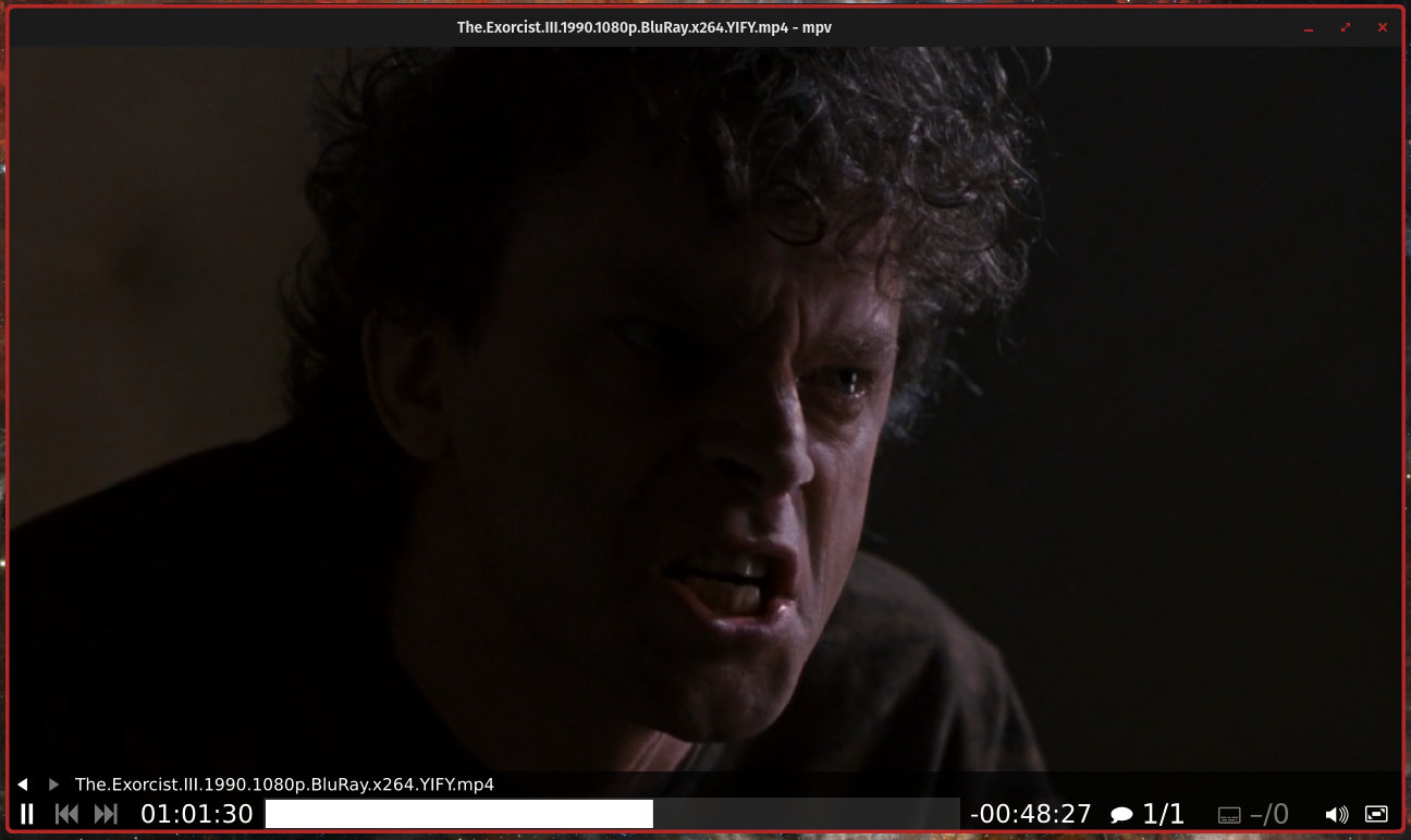

Oh ho ho... I just noticed that my video player (smplayer, but it's the mpv back end) doesn't work in Cosmic. I just didn't happen to watch anything in this DE yet (just youtube so far). Bad Window, invalid window parameter etc.
THAT will not do. Hopefully I can solve that with mpv (going to get git code and see if I need to enable something for Wayland etc.) That's actually a distro package I have installed. I shouldn't be using dogfood for that anyway. ( :sick: )
Nope... latest mpv from git, latest smplayer from git (that's more because arch has mpv as a package dependency and I needed to remove the mpv package) and mpv still can't create a window.
So that tells me it's not just Wayland but Cosmic-comp window manager itself causing these problems. It is likely the case with the game window and child window problems in Wine too.
Wayland is definitely supported in my mpv build.

Actually shit... the problem here is actually smplayer, using X11 not MPV. The Cosmic-comp window manager doesn't get the blame here at all either. I can launch mpv itself with a video on the command line, without smplayer trying to use "gpu-next/X11"
I think it's because smplayer is passing this, for some reason even though I have hwdec=vulkan. It isn't about that, I guess.
--gpu-context=x11egl
I actually didn't realize this had such a nice GUI window itself, mpv.
Also, it seems there is no more gpu-next, it's only gpu now. (vo=gpu)

Line 1765 in smplayer/src/core.cpp
if (proc->isMPV()) {
			if (pref->vo.startsWith("gpu")) {
				proc->setOption("gpu-context", "x11egl");
What possesses people to do things like this. No wonder smplayer is trying to use X11. It's hard coded to default to that, yet they give you no setting for gpu-context... I'd have to add it to command line arguments in Advanced which will hopefully override theirs if passed twice, but a consequence of using that field is that it will launch mpv in a separate window if you add arguments (with no controls on it, controlled by the SMplayer stop buttons and shit). As far as I know that's deliberate behaviour as that's how it was before.
Not "gpu" but "starts with gpu", so that means, vo=gpu, gpu-next, gpu-foo, gpu-kissmyass... anything. That's why this is happening to me. Oh well, I certainly can fix that, somehow. I can't just change it there though because if I change that context for vo=gpu* to something for wayland then it won't work for me under X11 lol
I think my solution may be to simply change that code to use "auto" for gpu-context. Since that works in the Advanced field (but pops up a separate window) it should work within the smplayer window unless that's tied to X11. (But then why would they have a "wayland support" checkbox in smplayer for MPV)
P.S. Unfortunately, the gpu-context has to be for X11 for SMplayer to use it within its window. It's simply a qt-X11 application. I patched it to use gpu-context=auto for mpv on linux ("unix not mac" actually lol), but it will open mpv in a separate window under Wayland. At least I geddit now.

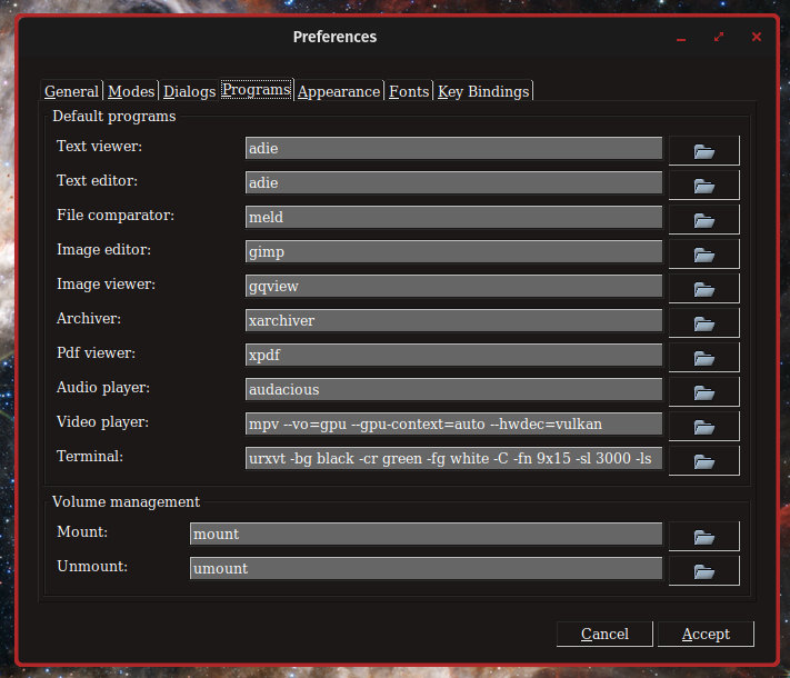

Seeing as mpv has such a nice GUI now (has mouse wheel controls for volume and position, full screen with a panel that comes up if you move the mouse... and looks good doing it, too), that's another method of opening videos. I don't really need smplayer, I can use it explicitly if i want to, or just open things in my XFE file manager. In those "Program" fields it will launch the file with whatever you put in there, correctly with the arguments you supply.
Of course, unless it's a special function like "Edit" or "View" a file association you add (e.g. through Open With, you can optionally check a box) is going to override that. So I removed the associations for video file types. Good old school software, it simply stores its entire configuration, including file type settings, in a flat INI type file with sections (xferc). So I did that first, and now when I double click a video in my XFE file manager it opens with that mpv command. :clap:
This has been a very handy file manager, for decades (formerly XWincommander, I think I found that for the first time in the assloads of programs that Mandrake 7.0 installed)
P.S. Actually, there's a --gpu-api=vulkan switch that I needed too. That was the missing piece of the puzzle to actually force vulkan video (has no choice now, it would fail if no vulkan with spirv compiler). This will work for both X11 and Wayland with the auto gpu-context setting. With the gpu-api and hwdec settings, that auto setting will now only be able to use x11vk or waylandvk for gpu-context.
mpv --vo=gpu --gpu-context=auto --gpu-api=vulkan --hwdec=vulkan
If that was on the command line, it would be followed by filename. (my file manager supplies that). I found out that hwdec isn't enabled by default, so it does need that. However, it depends on the file format as to whether or not it can be used. That setting will fall back to software decoding in that case. (This is not the same thing as rendering). With h264 it can use it:
[grogan@nicetry ~]$ mpv --vo=gpu --gpu-context=auto --gpu-api=vulkan --hwdec=vulkan filename.mp4
● Video  --vid=1               (h264 1920x1080 23.976 fps) [default]
● Audio  --aid=1  --alang=eng  (aac 2ch 48000 Hz 94 kbps) [default]
Using hardware decoding (vulkan).
AO: [pulse] 48000Hz stereo 2ch float
VO: [gpu] 1920x1080 vulkan[nv12]
Also, --vo=gpu-next DOES work in that context. Now though, vo=gpu works with vulkan output (man page still says you need gpu-next but this is latest git) so I can't decide which to use. Apparently gpu-next is faster, but it has some limitations and bugs. I guess I'll use gpu-next.
I got out the man page and actually waded through all the prose to understand those settings. It tells you vo= and gpu-context= but doesn't tell you the values, you have to go and read sections.
mpv doesn't have a full GUI, but it's got a nice enough player window when driven by command line that I don't think I'll miss smplayer. I'll bet that now I just won't use it anymore.
