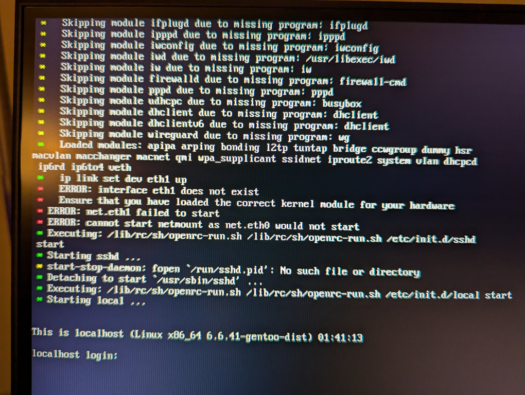

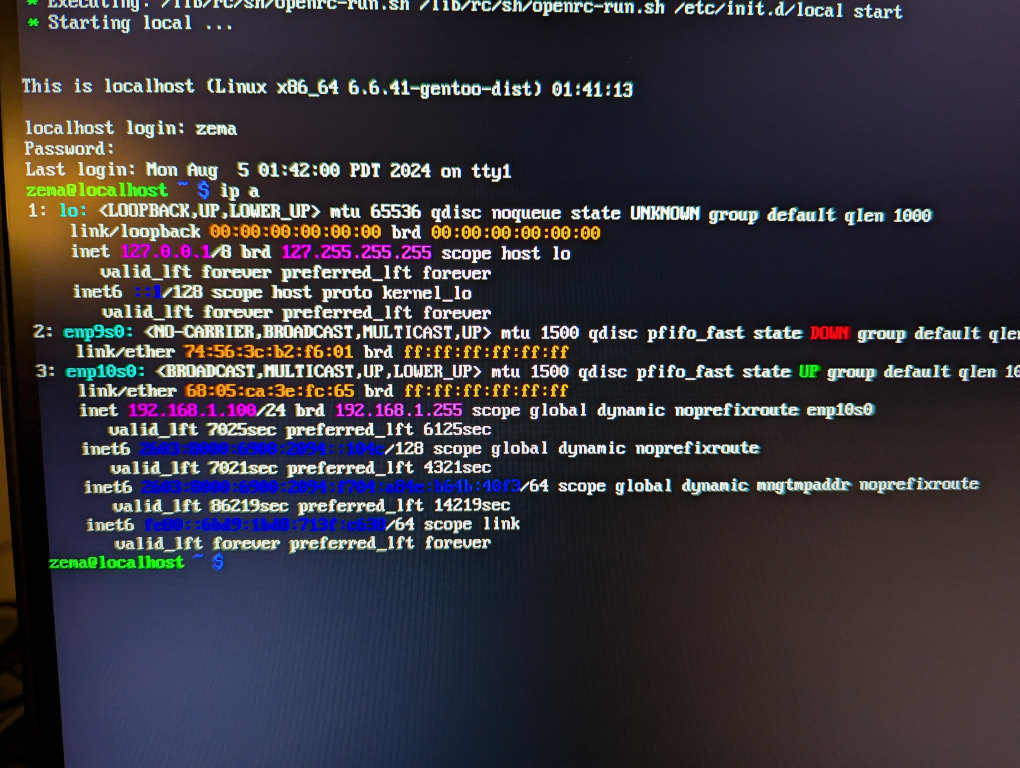

I got the base system up and working, my network interfaces changed from eth0 and eth1 to enp9s0 and enp10s0 so I have to fix that, but no time to sort that out tonight. I think I remember now that you dealt with this so I'll go back and review what you posted. But at least I ended up with a working system on the first try :)

What I do is make a udev rule in /etc/udev/rules.d to override the distro's rule. On Gentoo (and Arch) the filename you have to use is
/etc/udev/rules.d/80-net-setup-link.rules
SUBSYSTEM=="net", ACTION=="add", DRIVERS=="?*", ATTR{address}=="d8:bb:c2:d1:4b:1c", ATTR{dev_id}=="0x0", ATTR{type}=="1", KERNEL=="eth*" NAME="eth0"
SUBSYSTEM=="net", ACTION=="add", DRIVERS=="?*", ATTR{address}=="d8:bb:c2:d1:4b:1d", ATTR{dev_id}=="0x0", ATTR{type}=="1", KERNEL=="eth*" NAME="eth1"
Obviously use the correct MAC addresses for eth0 and eth1

To understand why that happened, the DHCP in Gentoo uses that nomenclature by default. Set up eth0 and eth1 statically, add those udev rules and you'll be grooving.

I checked and I already have config_eth0 and config_eth1 = "dhcp" in /etc/conf.d/net but the issue remains (I have connectivity though):
Something going on with non-existent modules too. It was getting late at the time so I just installed the binary kernel figuring I'd address that later, but that's why the LTS kernel.

You have the correct module, that other shit looks more like skipping loading modules because you don't have the front ends installed to use them. (That's WEIRD but this is Gentoo lol) Those aren't all kernel modules being listed, it's a bunch of module aliases and it looks like they are loading them based on installed helper programs. I don't use their kernel, and no initramfs of course so I don't see anything like that.
So the /etc/udev/rules.d/80-net-setup-link.rules lines didn't work on that kernel? That's the way I've been doing them for a long time on Slackware, Manjaroo, Arch, my LFS etc., but maybe that's not right for the Gentoo modular kernel with what they do in their initramfs or something. It's probably already initialized or something by the time those rules are processed.
I'm looking into it... if I can find info that isn't 15 years old.
Maybe you need to generate a new initramfs with a module alias in place or something. For that matter, how are you booting? Did you install Grub in Gentoo or did you add your kernel to another boot loader? The parameters may not be right for the Gentoo kernel (e.g. if you generated one with slackware's grub-mkconfig or something)
Re: Gentoo 2024
See if adding this to your kernel command line helps:
net.ifnames=0
That's not actually a "kernel parameter", it's udev that listens for that. Well, systemd, but Gentoo uses the actual systemd udev now (sys-apps/systemd-utils) for OpenRC as well, not their old eudev fork.
