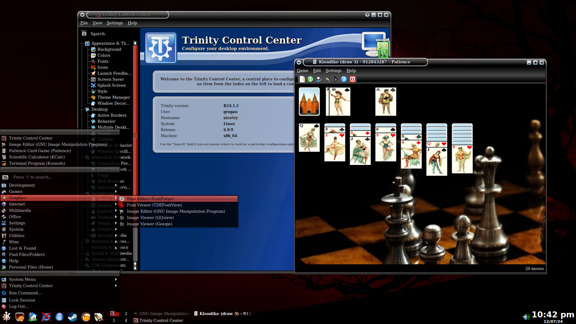

It was fairly smooth sailing after that. Set up taking far longer than the actual builds which take literally seconds (probably a minute for the big ones like libs and base). There was a time when it used to take me like 8 hours to build KDE 3 lol. It was better to just do single threaded builds, with no -j because it was too fast to see what was going on anyway, and when it stops on a failure it's easier to follow. Anyway, I built all the parts, and only the parts I use. All for alderlake instead of nehalem now as that old one that was built on the old computer on what was my manjaroo at the time.
It didn't lose any configuration, not a thing was out of place after it migrated the configs. It looks... pretty much the same as my TDE always looks. I love my blackened Keramik style. Except now I have that picom compositor, it's wonderful. That's real transparency there. Also, I'm getting a kick out of having animations in old X11 programs that have never had anything like that. That's because this sits above the client. I think it's affecting the card animations in my solitaire game too.
Here it is, my masterpiece that's been pissing me off since late last night, TDE 14.1.2
Right click and view image in new tab as this will be somewhat down scaled.

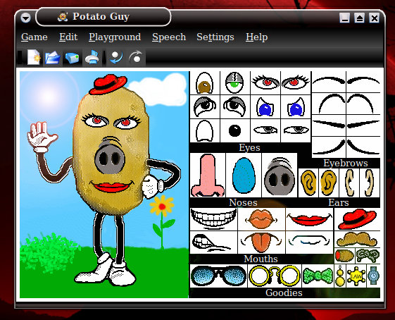

Oh yeah... I only build a few of the games (kshisen, kpat) but I added this one (ktuberling) this time so I could tease my nephew sometime while he's here. When he was little, back when I had KDE 3.x, I used to let him sit and play with that and he'd make a potato head guy and then, proud of himself, he'd get my attention and say "That's YOU!". I'm going to do that and see if he remembers :mrgreen:
